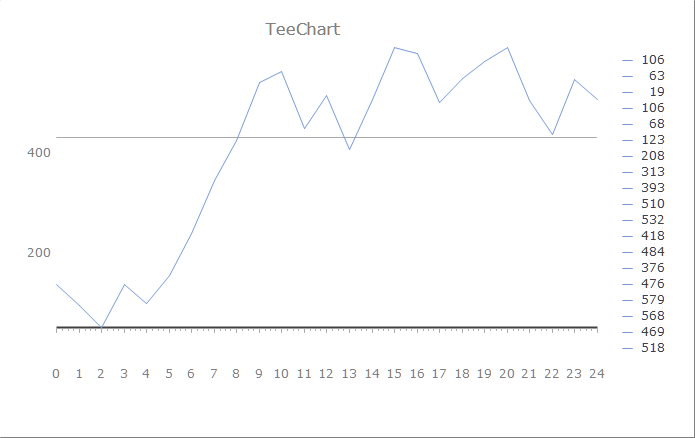

Is there a way to increase bottom axis labels Y position and left axis labels X position? I want to have an area between axis and label to draw own rectangle there.

One simple way to achieve this would be with code such as the following:
      tChart1.Panel.MarginBottom = 20;
      tChart1.GetAxisLabel += TChart1_GetAxisLabel;
    private void TChart1_GetAxisLabel(object sender, GetAxisLabelEventArgs e)
      e.LabelText = Utils.NewLine + Utils.NewLine + e.LabelText;
which gives me this:
