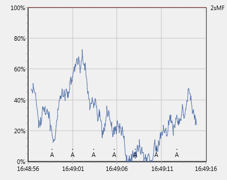

I have a TFastLineSeries that, for every 50th value entered, should display a single character at the bottom of the chart (but above the x-axis). I've got everything working as I intended, except for a small drawing issue. I'm not sure if it is "as designed" or an issue I've overlooked.
The way I've implemented is as follows:

Screenshot of output:
Please see the small dot right above the 'A'. Why is that there, and what to do to get rid of it? :)

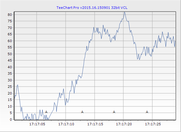

And this is what I'm getting:
I can't see any dot above the "A"s.
Am I missing any setting? Are you using the latest version available?
Re: Issue with drawing of series mark
Post by Yeray » Wed Mar 09, 2016 4:23 pm
Hello again,
I now see it is reproducible in FMX, not in VCL.
We'll be back to you asap.

I found what happens.
Since you are assigning new Positions to the marks, they are being used. However, the positions (TSeriesMarkPosition) include Width and Height and you aren't initializing them so they are 0.
Then, depending on the framework a rectangle with width=0 and height=0 is drawn (as a dot) or not.
To fix that, you can calculate the Widht and Height:
      APosition.Width:=Chart1.Canvas.TextWidth(Labels[i])+7;
      APosition.Height:=Chart1.Canvas.TextHeight(Labels[i])+5;
Or you can just hide the mark rectangles after creating the series:
Chart1[0].Marks.Transparent:=true;

However, if you want to draw a mark each 9 regular seconds, it would be easier if you stored only a reference point and draw all the labels from there.
Leo_
Posts: 11
Joined: Mon Dec 12, 2016 12:00 am
Post by Leo_ » Fri Feb 17, 2017 9:52 am
Thank you very much for your feedback, much appreciated.
1. Regarding the drawing issue of the characters (ID Codes): I just did a test where I create a second separate series for the ID Codes. It's a TPointSeries with Style set to "Nothing" to not show the point itself. Now I can add (Assign) a Mark to the point and use the default positioning and thus do not have to implement OnAfterDraw or Series.OnGetMarkText to reposition the Marks when the main graph is scrolling. It seems to work great, so I'll go for this solution.
2. Inconsistent spacing of marks: I agree, the combination of a TTimer and function the Now from the main Thread does not seem to be a good thing in this case. My incoming datastream for the real app (not the demo attached here) does not have a TimeStamp for the incoming datasamples as they are considered live data. Thus I have to use the "Now" function I think, but I'll wrap this part of my app in a separate thread. I would not be surprised if this solves the issue :)
3. Speed: I've done some more testing and on my three available devices it is actually the 10" pad that seems to suffer the most. This device is now running on Android 5.0.1. What I'll do:
- Improve my own code by using threads
- Follow the hints you provided in the link
- Upgrade the device to maybe Android 6
Once again thank you for the support.
