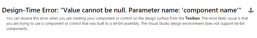

NSAI wrote: I read in your forum that you have to use 32 bit control at the design time and change reference to 64 bit for the release. This is extremely cumbersome. I have 4 or 5 projects in my solution that uses TChart control. Do I have to change the reference every time for all the 4-5 projects before the release? I do multiple builds in a week and this will be very difficult. Is there an easier solution?
I'm afraid there isn't. The Visual Studio designtime surface is an 32-bit application and so is incompatible with 64-bit controls, as Microsoft says here:
