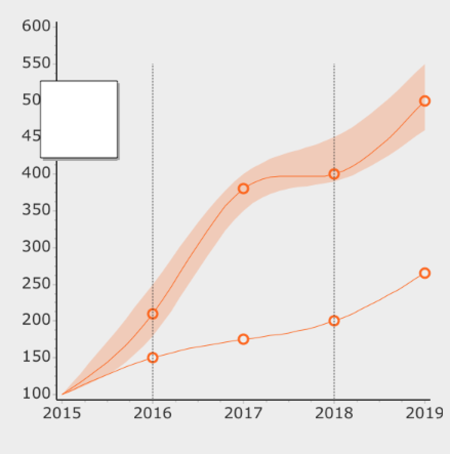

I am trying to show an image in an annotation, in Xamarin Forms. I already tried a lot of different things and i can't get it to show the image... Does anyone have a solution?
Here is what I've tried so far...
 var annotation = new Steema.TeeChart.Tools.Annotation(c);
           var image = new Image();
           image.Source = "Home-Orange.png";
           annotation.Shape.Image = image;
           c.Tools.Add(annotation);
I also tried with annotation.Shape.Brush.Image, and annotation.Callout.Brush.Image, and also tried the same with the rectangle tool, but all to no avail...
In the attachment is a screenshot of what I've got so far... As you can see, it's just a white box that shows :)
Thanks in advance,
Screen Shot 2015-11-19 at 11.00.50.png (72.56 KiB) Viewed 34283 times

I think this may be related to my problem which is described here:
http://stackoverflow.com/questions/3248 ... draw-image
The bug is here:
http://bugs.teechart.net/show_bug.cgi?id=1299
The status is IN_PROGRESS, so I guess the dev team is fixing it right now. :)

Hello everyone,
IliaStoilov wrote: The status is IN_PROGRESS, so I guess the dev team is fixing it right now. :)
Yes, we are currently worknig on it. I'll let you know when we have some news.

But is there a timeframe for when this will be solved or is there a work around for it? Because I really need this to be solved soon.
Currently we just place the image above the graph and calculate the X value of it, but this is not what we want.
Thanks!
Re: Annotation tool with image
Post by Narcís » Wed Nov 25, 2015 3:42 pm
Just sent you an email with the URL to download a new installer. This issue has been fixed in iOS and is not completely solved for Android, we are still working on it.
