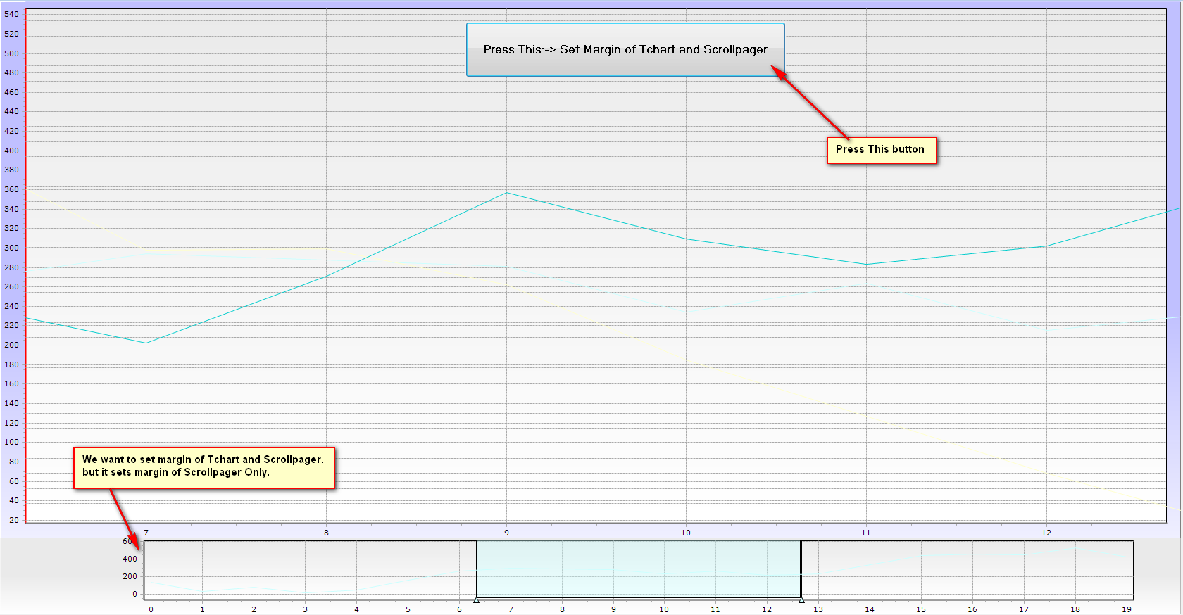

We have some issue related to the margin of Scrollpager and Tchart,
In the attached demo, Click on "Press This:-> Set Margin of Tchart and Scrollpager" Button. On this button we set the margin of Scrollpager as well as Tchart using below Code.
m_ScrollPagertool.SubChartTChart.Panel.MarginLeft = 10;
tChart1.Panel.MarginLeft = 10;
It sets the margin of Scrollpager only as shown in below Image.
We also want to Set margin of Tchart.

amol wrote:It sets the margin of Scrollpager only as shown in below Image.
Which version of TeeChart.dll are you using?
In the latest version, pressing the button has no effect on the chart.

Thanks for reply,
We are using 4.1.2012.5103 version of TeeChart.

amol wrote: We are using 4.1.2012.5103 version of TeeChart.
In this case, as I believe I have suggested before, the solution is to upgrade to the latest version.
