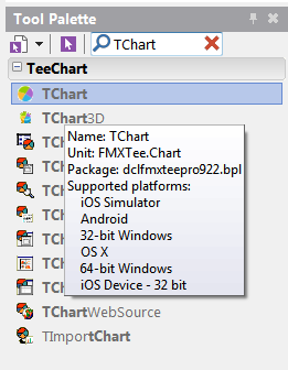

after installation of the latest TeeChart FMX from souces, via the TeeRecompile.exe TChart is diabled for the 64Bit iOS platform.
teeChart disabled for 64Bit iOS platform
Is that done on purpose, because there are problems ?
best regards and thanks
Re: TChart disabled on 64Bit iOS platform
Post by Narcís » Fri Jun 12, 2015 1:29 pm
Hello X-Ray,
If your application targets an iOS 64-bit device, TChart is still available there and builds correctly. You need an iOS 64-bit device to run it though. Did TeeRecompile run fine for iOS 64-bit device? Does this work for you?

I have an iPhone 6 and other components are enabled for the 64Bit iOS platform.
Also the TeeRecompile did run fine for the 64Bit iOS platform.

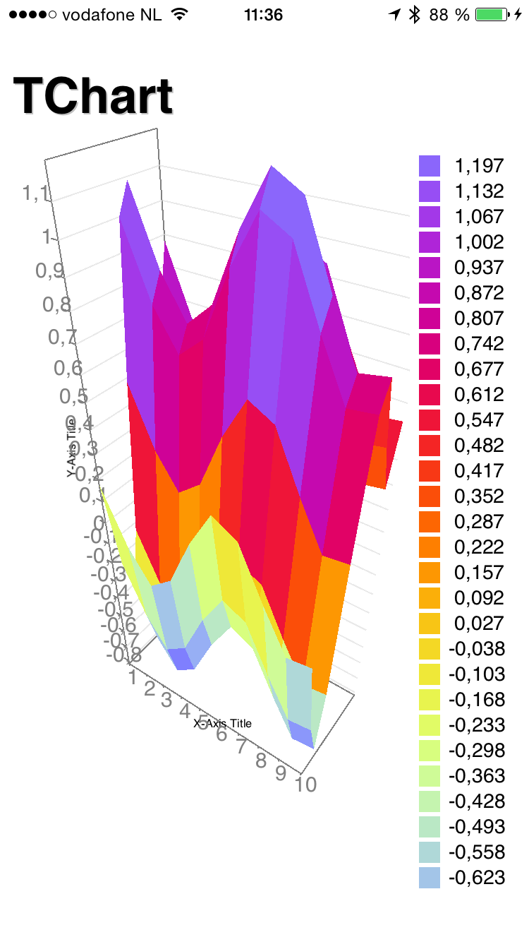

there are problems with axes titles in 3D that got worse with the latest release 2015.16:
Foto 08.09.15 11 36 51.png (131.62 KiB) Viewed 41627 times
I used the gesture example and added titles for the X-Axis (Bottom Axis), Y-Axis (Left Axis) and the Z-Axis (Depth Axis). What you see is (on a iPhone 6):
1) The titles are not aligned with the axis labels (This works well in the VCL version)
2) The distance between the axis labels and the axis title is too short (how can I change this ?)
3) The Z-Axis title has disappeared or is somewhere far away
Are there any fixes for this ?
best regards,
X-ray

X-Ray wrote:there are problems with axes titles in 3D that got worse with the latest release 2015.16:
I've tried it with v2015.15 and v2015.16 in Android and it seems to give the same result. Could you please specify what two versions to compare?

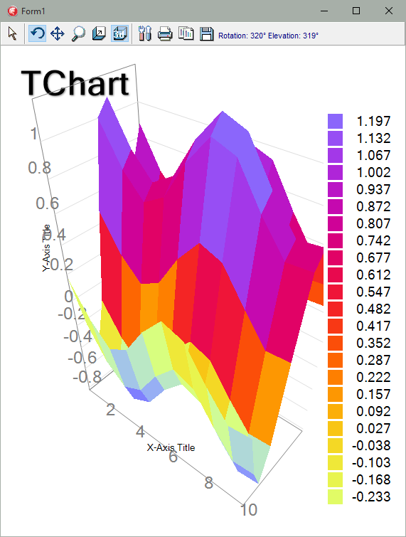

X-Ray wrote:1) The titles are not aligned with the axis labels (This works well in the VCL version)
I get the same result with VCL:
X-Ray wrote:2) The distance between the axis labels and the axis title is too short (how can I change this ?)
I'm afraid this is not possible.

X-Ray wrote:3) The Z-Axis title has disappeared or is somewhere far away
The depth axis is not visible. It will appear if you make it visible:
Chart1.Axes.Depth.Visible:=true;
