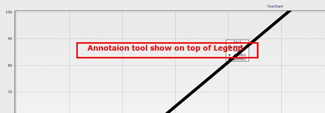

Hi Steema Support,
Why Tools are shown above the series as shown in fig.
Tools are shown on the top.
Tool are on tool1.png (123.58 KiB) Viewed 9804 times
Here DrawlineItem and Annotation shown above the Legend . Is there is any way to display Legend above these tools.
Please provide any solution.

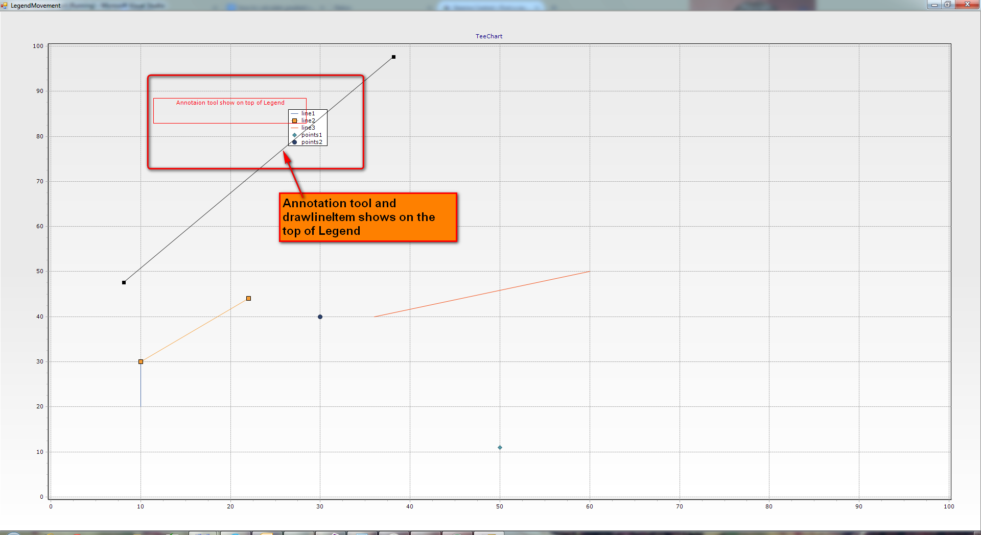

Hi Steema Support,
Thanks for your reply.
I am attaching an image to clarify the issue.
Legend must be on top.
As shown in image, that Annotation Tool(Rectangle that is shown with text) and a DrawLineItem Tool(Thick Black line shown) covers the legend or we can say we can not see complete legend clearly. So here we want that Legend must be shown above these tools so we can read legend clearly.

amol wrote: As shown in image, that Annotation Tool(Rectangle that is shown with text) and a DrawLineItem Tool(Thick Black line shown) covers the legend or we can say we can not see complete legend clearly. So here we want that Legend must be shown above these tools so we can read legend clearly.
Seeing this image I have the impression the legend is manually set to a custom position, it is not using default positions (LegendAlignments.Left, LegendAlignments.Right, LegendAlignments.Top and LegendAlignments.Bottom). So you should calculate the legend position not to overlap either with the Annotation and DrawLine tools.
If you want us to look at the issue with more detail please send a Short, Self Contained, Correct (Compilable), Example project to reproduce the problem here.

Post by amol » Mon Dec 29, 2014 11:55 am
Hi Narcis,
We do not want to move legend any where.Is it possible that legend always show on the front?
PlanoResearch
Re: Tools are shown on the top.
Post by Narcís » Mon Dec 29, 2014 12:03 pm
amol wrote: We do not want to move legend any where.Is it possible that legend always show on the front?
In that case you won't be able to solve the problem unless you move the tools instead.
amol wrote: Is it possible that legend always show on the front?
Not the default legend. However, you may achieve that plotting a custom legend as in the example Christopher Ireland posted here.
