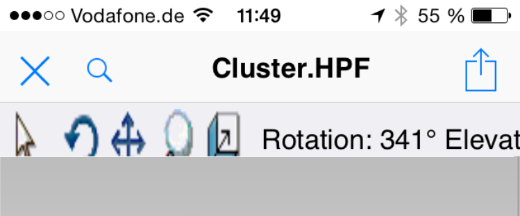

I am using a TTeeCommander component in an iOS project.
But somehow the buttons/bitmaps are always cut on the bottom of
TeeCommander toolbar, like in the attached screen shot.
Is there any way to correctly display these button?

Have you tried to resize it?
Does it happen in the simulator or only in a real device?
Also note the editor/commander have been designed to help the developer to build and test their applications. These tools aren't designed to be accessed by the final users, so we don't recommend giving access to it.

Hello Yeray,
Yes, I tried to re-size it but it doesn't help. And the display is the same on the simulator too.
What is the recommended way to bind own toolbar buttons to the same functions?
