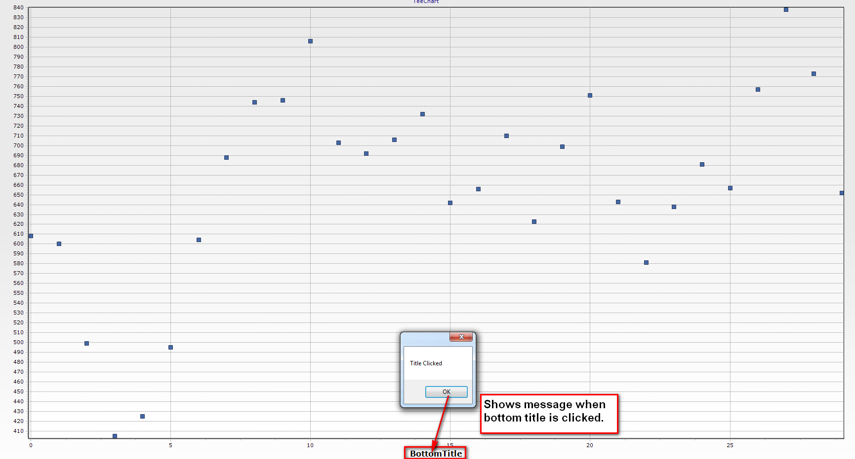

Hi Steema Support,
Is it possible to show message box on clicking Title of the axis. As shown in attached image.
please provide any solution for the same, it is very helpful to us.
Thanks&Regards
PlanoResearch
Re: Click Event on Bottom Title
Post by Christopher » Mon Nov 17, 2014 10:12 am
You can use:
      tChart1.MouseDown += tChart1_MouseDown;
      tChart1.Series.Add(typeof(Bar)).FillSampleValues();
      tChart1.Axes.Bottom.Title.Text = "bottom axes";
    void tChart1_MouseDown(object sender, MouseEventArgs e)
      if (tChart1.Axes.Bottom.Title.Clicked(e.X, e.Y))
        MessageBox.Show("Title Clicked");
