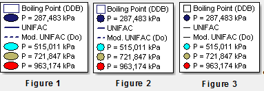

since the last build the legend symbols are not drawn as before.
We are not able to get the old behavior back using the available options.
We are using GDI (not GDI+).
Example:
A 2D chart with four point/line series with nearly default options, a point/line series with transparent point background and two line series with thick lines, no pointers and one with dashed line.
The old legend looks like this:
Legend (old behavior)
Now the point symbols in the legend are much too large and not squared (Figure 1):
Legend new with different options
If I set Legend->Symbol->Squared = true then the pointer symbols have a bad border and the line style can hardly be recognized (Figure 2).
Now if I turn off the default border of the symbols then the pointer symbols look nice but the line style and color of the series without pointers is gone (Figure 3).
Is there a way to get the old behavior back?

There's no other way I can think of than reverting your installation back to an older version. That looks like a regression, could you please add it to bugzilla? Doing so you'll be identified as the creator of the issue and therefore notified about its evolution.
