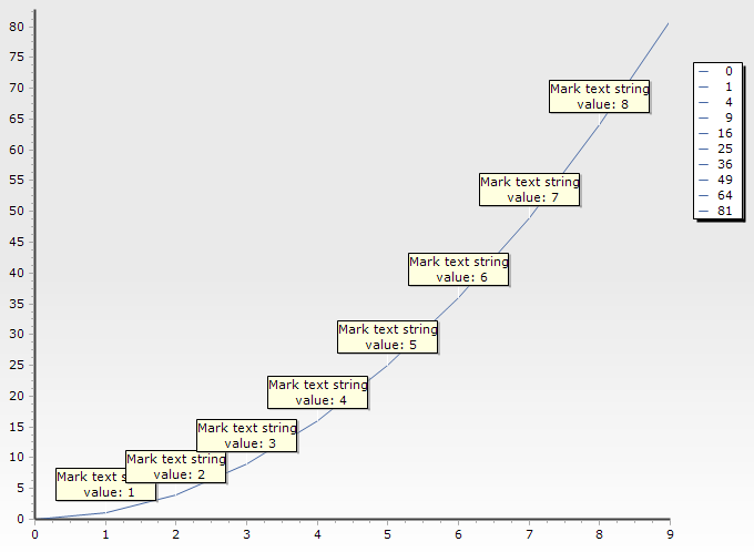

Dear,
I have a line chart with series marks that contain 2 lines of text. When the first line is longer then the second one, the series marks are not resized correctly. This means that there is no space between the letters and the border of the series marks and sometimes the text even goes outside of the border.
If the second line is longer then the first one, everything works fine.
Is it possible to resize this properly?
My code is the following:
void lineSeries_GetSeriesMark(Steema.TeeChart.Styles.Series series, Steema.TeeChart.Styles.GetSeriesMarkEventArgs e)
            e.MarkText = "Mark text string \n value: " + e.ValueIndex;
            Steema.TeeChart.Styles.Line line = new Steema.TeeChart.Styles.Line(tChart1.Chart);
            Steema.TeeChart.Styles.SeriesMarks marks = new Steema.TeeChart.Styles.SeriesMarks();
            line.GetSeriesMark += new Steema.TeeChart.Styles.Series.GetSeriesMarkEventHandler(lineSeries_GetSeriesMark);
            for (int i = 0; i < 10; i++)
               line.Add(i*i);
Series marks issue.PNG (17.76 KiB) Viewed 7798 times

Hello OMP,
Isn't the Autosize problem, so, Autosize works in correct way. The behavior is produced when is calculated the position of string text that depends the size of string and the font type. I consider interesting create a property allows users control the margins of Marks and other TextShapes. I have added this idea as a feature request with number [TF02016687] to consider its inclusion to upcoming maintenance releases of TeeChartFor.Net.
On the other hand, to prevent o treat the problem appears in your mark shape, I give you some suggestions:
You can control the margin when you set AutoSize property to true, adding space before and after of the mark text. As is done in next simple code:
      line.Marks.Visible = true;
     // line.Marks.TextAlign = StringAlignment.Center;
        line.Add(i * i);
      tChart1.Draw();
      line.GetSeriesMark += line_GetSeriesMark;
      button1.Click += button1_Click;
      //tChart1.Axes.Left.MaxLabelsWidth();
    void line_GetSeriesMark(Series series, GetSeriesMarkEventArgs e)
      //Use AutoSize as true
      e.MarkText = "    Mark text string     \n value: " + e.ValueIndex;
You can disable marks AutoSize property and after you can use custom size and calculate the size with MeasureString method of TeeChart Canvas as is done in next code:
        line.Add(i * i);
      tChart1.Draw();
      //Disable AutoSize when use custom size
      line.Marks.AutoSize = false;
      //Use a custom size of marks.
      SizeF s = tChart1.Graphics3D.MeasureString(series.Marks.Font, e.MarkText);
      series.Marks.Width = ((int)s.Width) + 10;
      series.Marks.Height = ((int)s.Height) + 2;
Could you tell us if previous code works in your end?
