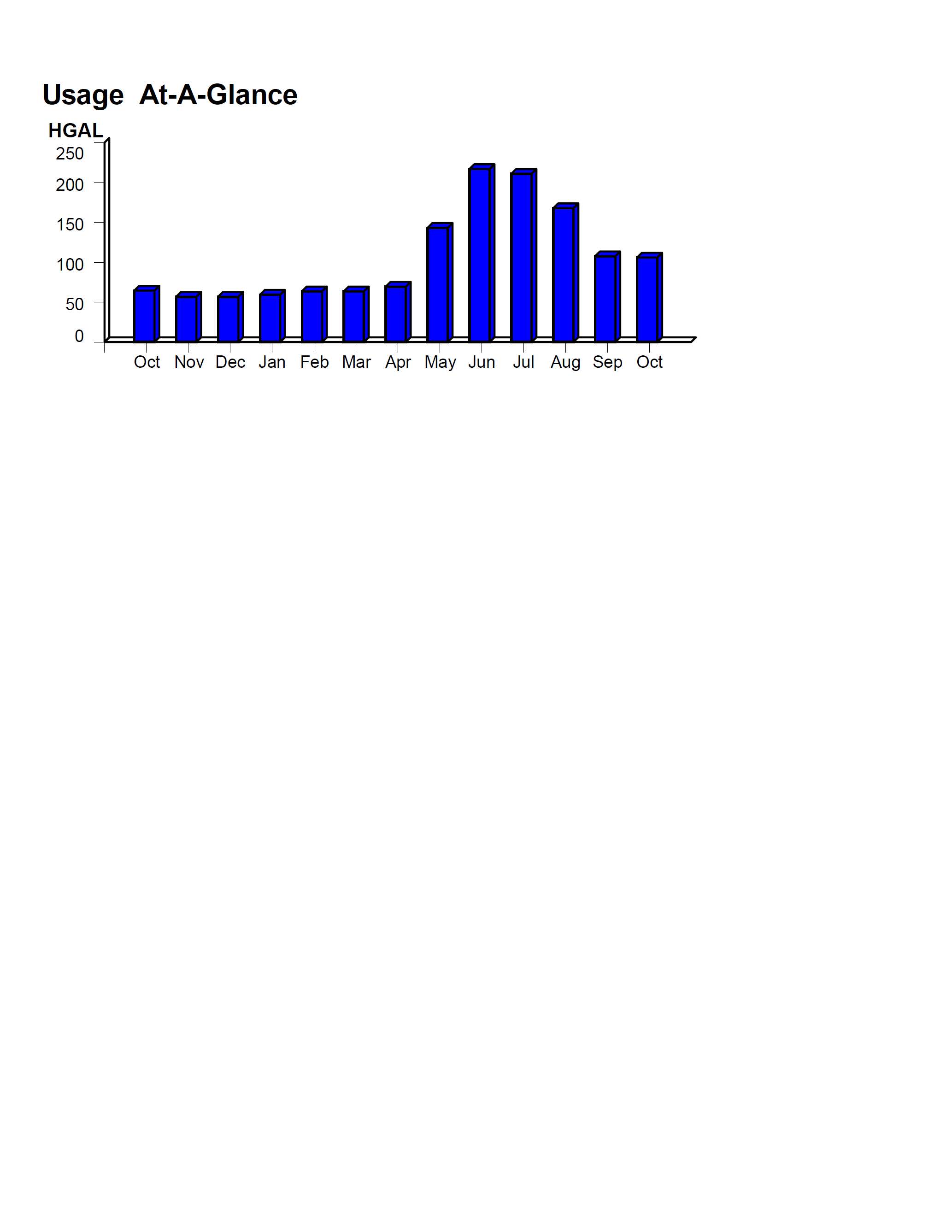

This is the output we want to achieve.
This is the graph currently being generated.

1. I need to rotate the 3D Bar chart on its "Z" axis to achieve a "flatter" perspective.
2. I need to be able to control the depth of the generated 3D bars to make them appear "thinner" 3D-wise.
3. I need to be able to have a 3D-effect applied to the X-Axis and the Y-Axis to give additional 3D-looking perspective to the graph.
4. I need to be able to have the individual graph bars constructed/painted using a heavy black pen with a blue interior to each bar. We are currently able to build each bar using the blue color but now wish to add a heavy-pen black outline to each bar for clarity.
5. I wish to have the Y-axis of the graph depict the values displayed in thousands.

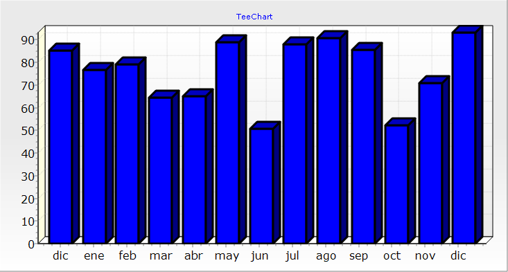

PrinterGuy wrote:4. I need to be able to have the individual graph bars constructed/painted using a heavy black pen with a blue interior to each bar. We are currently able to build each bar using the blue color but now wish to add a heavy-pen black outline to each bar for clarity.
By default the Pen is visible. Anyway, in the code below I'm forcing it to be visible:
  Dim i As Integer
  TChart1.AddSeries scBar
  With TChart1.Series(0)
    .XValues.DateTime = True
    .Color = vbBlue
    .Marks.Visible = False
    .Pen.Visible = True
    .Pen.Width = 3
    For i = 0 To 12
      .AddXY DateAdd("m", i, Today), 50 + Rnd * 50, "", vbBlue
    Next i
  End With
  TChart1.Axis.Left.Labels.Font.Size = 12
  TChart1.Axis.Bottom.Labels.Font.Size = 12
  TChart1.Axis.Bottom.Labels.DateTimeFormat = "mmm"
And this is what I'm getting:
