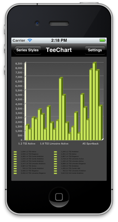

you're corect about the "LeftPercent" property, in NET code the equivalent is:
_controller.chart.Legend.TopLeftPos = -45;
using the following code (most of them is your code) I get the attached image, do you get the same results ? In case that not, please send us the resulted image so we can investigate which the problem is.
				Steema.TeeChart.Styles.Bar SeriesBar = new Steema.TeeChart.Styles.Bar(_controller.chart.Chart);
				SeriesBar.Title ="Quantity";
				SeriesBar.Marks.Visible = false;
				SeriesBar.Add(1644,"1.2 TSI Active");
				SeriesBar.Add(1240,"1.2 TSI Ambition");
				SeriesBar.Add(2506,"1.2 TSI Elegance");
				SeriesBar.Add(2351,"1.4 TSI Active");
				SeriesBar.Add(3385,"1.4 TSI Combi Ambition");
				SeriesBar.Add(2867,"1.4 TSI Elegance");
				SeriesBar.Add(1230,"1.6 TDI Combi Ambition");
				SeriesBar.Add(3718,"1.6 TDI Limosine Active");
				SeriesBar.Add(1935,"1.8 TSI Combi Ambition");
				SeriesBar.Add(1190,"1.8 TSI Limosine Active");
				SeriesBar.Add(2147,"1.8 TSI Limosine Ambition");
				SeriesBar.Add(6888,"1.8 TSI Limosine Elegance");
				SeriesBar.Add(4987,"2.0 TDI Active");
				SeriesBar.Add(1928,"2.0 TDI Ambition");
				SeriesBar.Add(742,"2.0 TDI Combi Ambition");
				SeriesBar.Add(1455,"2.0 TDI Combi L&K");
				SeriesBar.Add(3068,"2.0 TDI Elegance");
				SeriesBar.Add(763,"2.0 TDI Limosine Ambition");
				SeriesBar.Add(5092,"2.0 TDI Limosine Elegance");
				SeriesBar.Add(3613,"3.6 VG Combi Ambition");
				SeriesBar.Add(2270,"3.6 VG Combi Elegance");
				SeriesBar.Add(7843,"A5 Sportback");
				SeriesBar.Add(8565,"A6 Avant");
				SeriesBar.Add(7724,"A6 Limousine");
				SeriesBar.Add(3784,"Comfortline");
				_controller.chart.Series.Add(SeriesBar);
				_controller.chart.Legend.Transparent = true;
				_controller.chart.Legend.Visible = true;
				_controller.chart.Legend.Alignment = LegendAlignments.Bottom;
				_controller.chart.Legend.Symbol.WidthUnits = LegendSymbolSize.Pixels;
				_controller.chart.Legend.Symbol.Width = 10;
				_controller.chart.Legend.Symbol.Position = LegendSymbolPosition.Left;
				_controller.chart.Legend.TextAlign = MonoTouch.CoreText.CTTextAlignment.Justified;
				_controller.chart.Legend.TextSymbolGap = 0;
				_controller.chart.Legend.ColumnWidthAuto = false;
				int[] LegendColWidth = {25,95};
				_controller.chart.Legend.ColumnWidths = LegendColWidth;
				Steema.TeeChart.Drawing.ChartFont LegendFont = new Steema.TeeChart.Drawing.ChartFont();
				LegendFont.Size = 5;
				_controller.chart.Legend.Font = LegendFont;
				_controller.chart.Legend.HorizMargin = 0;
				_controller.chart.Legend.VertMargin=0;
				_controller.chart.Legend.Left = 0;
				_controller.chart.Legend.VertSpacing = 0;
Captura de pantalla 2012-08-31 a la(s) 14.18.39.png (120.61 KiB) Viewed 28721 times

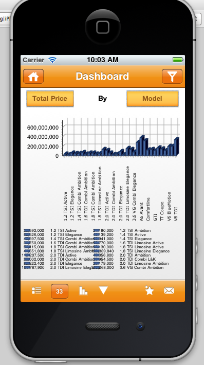

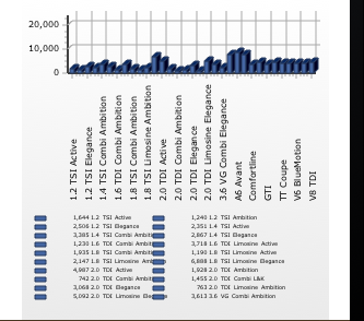

Post by incadea » Mon Sep 03, 2012 6:51 am
We have implemented the code provided above. There is lot of improvement in the spacing.
Now the left column is still overlapping on the right column's symbol by 3-4 characters.
The only difference between your image and the image generated by us is that in your image there is no gap between legend numeric value and text i.e. (1,644 1.2 TSI Active), but in our image there are 2-3 spaces between legend numeric value and text.
If we reduce this space then our problem can be solved.
Following is the source code:
            this.chart.Walls.Visible = false;
            this.chart.Header.Visible = false;
            this.chart.Axes.Bottom.Labels.Angle = 90;
            this.chart.Axes.Bottom.Labels.TextAlign = MonoTouch.CoreText.CTTextAlignment.Left ;
             //To disable chart movement on scroll/drag
            this.chart.Panning.Active = false;
            this.chart.Panning.Allow = ScrollModes.None;
            this.chart.Legend.Transparent = true;
            this.chart.Legend.Visible = true;
            this.chart.Legend.Alignment = LegendAlignments.Bottom;
            this.chart.Legend.Symbol.WidthUnits = LegendSymbolSize.Pixels;
            this.chart.Legend.Symbol.Width = 10;
            this.chart.Legend.Symbol.Position = LegendSymbolPosition.Left;
            this.chart.Legend.TextAlign = MonoTouch.CoreText.CTTextAlignment.Left ;
            this.chart.Legend.TextSymbolGap = 0;
            this.chart.Legend.ColumnWidthAuto = false;
            this.chart.Legend.ColumnWidths = LegendColWidth;
            this.chart.Legend.Font = LegendFont;
            this.chart.Legend.HorizMargin = 0;
            this.chart.Legend.VertMargin=0;
            this.chart.Legend.Left = 0;
            this.chart.Legend.VertSpacing = 0;
            this.chart.Legend.TopLeftPos = -45;
Please let us know how can we reduce the gap between the legend numeric figure and text.

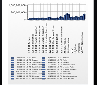

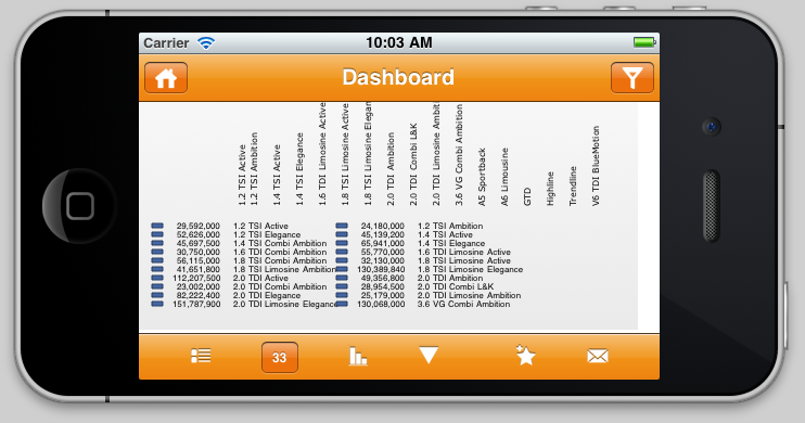

Post by incadea » Wed Sep 05, 2012 4:48 am
Hello
Please see the attached screenshots:
Screen shot of legend display in landscape

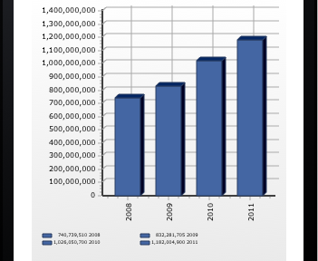

I have implemented in my project. Please see the following screen shots:
Screen shot 2012-09-21 at 12.04.04 PM.png (46.16 KiB) Viewed 28554 times
Screen shot 2012-09-21 at 12.04.24 PM.png (56.09 KiB) Viewed 28581 times
Screen shot 2012-09-21 at 12.03.39 PM.png (52.33 KiB) Viewed 28580 times
As you can see that there is still some space on the right side of the 2nd column of legend which can be utilized
and display improved. Also the font size of legend is now very small which is reducing it's readability.
Following is my source code:
            this.chart.Legend.TextAlign = MonoTouch.CoreText.CTTextAlignment.Left;
            this.chart.Legend.TextSymbolGap = 3;
            if (this.InterfaceOrientation == UIInterfaceOrientation.LandscapeLeft || this.InterfaceOrientation == UIInterfaceOrientation.LandscapeRight)
                int[] LegendColWidth = {70,80};
            } else
                int[] LegendColWidth1 = {33,57};
                this.chart.Legend.ColumnWidths = LegendColWidth1;
            this.chart.Legend.TopLeftPos = -40;
Please let me know how to improve the legend display.
Re: Legend margin with 2 columns of legend
Post by Sandra » Tue Sep 25, 2012 12:31 pm
Hello incadea,
Sorry for the delay. Basically, the legend automatically calculates internally a limit that indicates the space need legend to paint its text correctly. In same way, limit influences directly in the columns of legend,so, it is used to decided if can be painted or not a column in legend rectangle. In your case, you are working in the limit of legend bounds and when you change columns size you reduce the automatic space text you have, to paint and causes texts overlapping. It problem doesn't have easy solution and the only alternative you have is customize your legend. I suggest you some ways to try achieve as you want:
1.- You can use a extralegend.
2.- You can customize text, for if exceed the maxim number of caracaters or size, draw "...".
3.- Paint the lengend directly in the canvas.
4.- Try to reduce the size of font.
I hope will helps and if you have any problems please, let me know.
