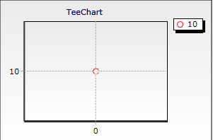

The source point is ok:
But result XAML is incorrect, right and bottom borders of the point are erased:

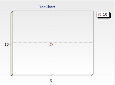

Hello neurosoft,
I can not reproduce your problem using last version of TeeChartFor.Net and your code and I am get next results:
Can you tell us, step to step, how we have do to reproduce your problem?

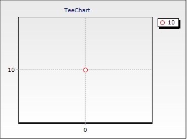

Hello neurosoft,
I am afraid still cannot reproduce your problem here using your code I get next results:
Can you tell us how you do to open the xaml image? I have opened the xaml using Windows Inernet Explorer 9 and is seen good. I think probably the problem is the program are you open the xaml
