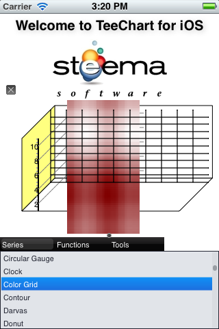

I tried that example but there are obviously major drawing problems on iOS, especially
with the text on the axes. Just have a look at the attached screen shot from the simulator.

Post by Narcís » Wed Mar 14, 2012 2:50 pm
Hi X-Ray,
This is probably related to a Delphi bug: http://qc.embarcadero.com/wc/qcmain.aspx?d=103976. The workaround is modifying "/Developer/Embarcadero/fmi/FMX_Types_FPC_Impl.inc" as described in the Quality Central description. Due to 103976 many TRectF methods are failing.

Post by X-Ray » Thu Mar 15, 2012 8:20 am
Hi Narcis,
Thank You!
That fixed all the problems, TeeChart is now working nicely on iOS!
