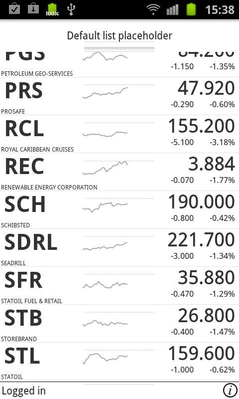

I have added a chart to a list view item. The strange thing is the scroll artifact that is created at the top and the bottom. I have tried changing a few things and determined that the second Line() added to the chart is the one that appears as the defect.

Hi Cameron,
I've been able to reproduce it so I've added it to the defect list to be revised in future releases (TJ71016072).
Thanks for reporting it.
