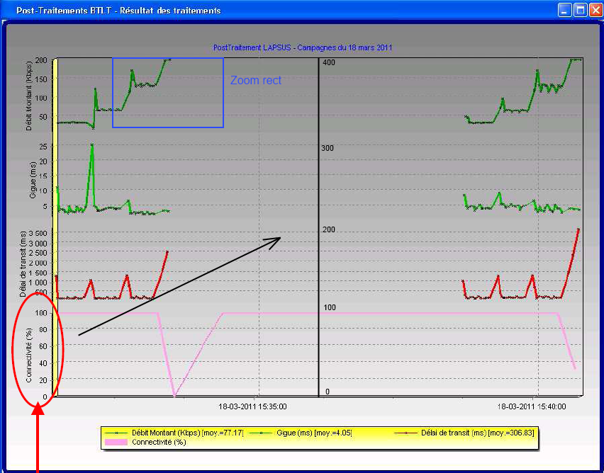

The top three vertical axes are custom axes and the last vertical axis, the signalized in red, is the default left axis. With it, I guess the zoom rectangle you drew with the mouse is something similar to the blue rectangle in the picture below. Am I right?
Note that only the default axes (left, right, bottom, top) zoom automatically. That's why the three vertical axes on top aren't rescaled when you zoom.
And the same reason explains why the left axis takes (322.632, 395.789) as new scale. You are probably drawing the zoom rectangle where these values would be if the left axis was larger. An image usually explains more than thousand words:
left axis.png (273.73 KiB) Viewed 14056 times
So, when you are drawing a zoom rectangle on the blue area, you are actually telling the left axis you want it to be rescaled to 322, 395. But there is no point in that scale for the pink series.. so nothing is shown.
You can draw a zoom rectangle anywhere in the ChartRect, but only the default axes are going to be rescaled by default. It doesn't matter if the default axes aren't defining the same zone.
