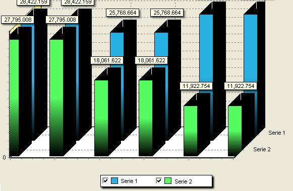

We are exploring plots with bar series type. In the attachment you can see how the color of each serie goes to black with the gradient property. Using the following code:
TCrart1:Series(p-SeriesIndex):asBar:Gradient:StartColor = RGB-VALUE(RANDOM(0,255),RANDOM(0,255),RANDOM(0,255))
TCrart1:Series(p-SeriesIndex):asBar:Gradient:MidColor   = TCrart1:Series(p-SeriesIndex):asBar:Gradient:StartColor
TCrart1:Series(p-SeriesIndex):asBar:Gradient:EndColor   = TCrart1:Series(p-SeriesIndex):asBar:Gradient:StartColor
TCrart1:Series(p-SeriesIndex):COLOR = TCrart1:Series(p-SeriesIndex):asBar:Gradient:StartColor
Is it black the default color that appears on the depth and top of each bar? How can I change it?
Besides, the first bar at the left appears truncated, it does not have the same width as the others. The same comment is valid for the extreme right serie but with the depth side of the bar, as is clearly seen in the image. Is there a command that we are missing?

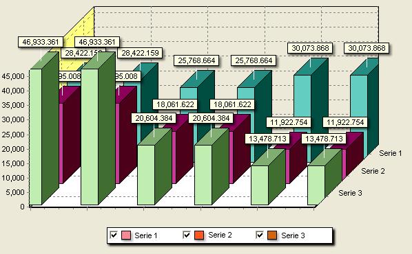

What extra code we need for change no just the legend color but also the bars color? (attachments)

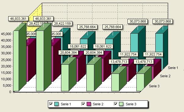

I'm still not sure to understand if you want gradients or not. If you want gradients, assigning the same color for each series color, startcolor, midcolor and endcolor is the same than not using gradients.
Anyway, both with gradients or without, I see how both the bars and the respective legend symbols change in a simple application:

Let me try to explain. When a series value hasn't a color assigned, the color of the series is used to draw it. However, as soon as you add your values with color, this color is used to draw the point.
So you have two options here:
1. Add your values without color (using clTeeColor as color parameter) so the series color will be used to draw its points. Then, changing the series color will modify both the series points and the series legend symbol. Example:
