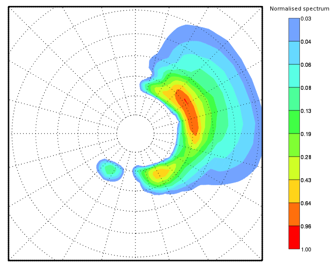

How can you make a 3d polar surface graph (angle, radius, value) ?
Re: polar surface graph
Post by Yeray » Fri Jun 10, 2011 8:06 am
Hello Blue,
There are the Polar series and the Surface series. I'm not sure to understand what exactly is a 3D Polar Surface. Could you please show us a picture of it?
Thanks in advance
Post by Yeray » Fri Jun 10, 2011 12:16 pm
Hello Blue,

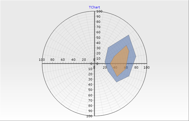

I've received your picture showing how the polar surface looks like. Thank you.
I post it here for other customers benefit (if you want me to remove it, don't doubt to ask for it)
There isn't a series specially thought to do something like that. However it can be done with a TPolarSeries and some customization:
uses TeePolar, TeCanvas, TeeGDIPlus, TeePNG;
  Chart1.Canvas:=TGDIPlusCanvas.Create;
  Chart1.View3D:=false;
  Chart1.Legend.Visible:=false;
  with Chart1.AddSeries(TPolarSeries) as TPolarSeries do
    Circled:=true;
    Pointer.Visible:=false;
    Pen.Visible:=false;
    Transparency:=50;
    AddPolar(10,20);
    AddPolar(50,40);
    AddPolar(40,85);
    AddPolar(10,80);
    AddPolar(-20,70);
    AddPolar(-40,55);
    AddPolar(-30,30);
    Circled:=true;
    Pen.Visible:=false;
    Transparency:=50;
    AddPolar(0,30);
    AddPolar(20,40);
    AddPolar(30,70);
    AddPolar(20,70);
    AddPolar(-10,60);
    AddPolar(-30,50);
  Chart1.Axes.Left.SetMinMax(0,100);
  Chart1.Axes.Bottom.SetMinMax(0,100);
var i, j: Integer;
    points: array of TPoint;
    blend : TTeeBlend;
    SetLength(points, Chart1[i].Count);
    for j:=0 to Chart1[i].Count-1 do
      points[j].X:=Chart1[i].CalcXPos(j);
      points[j].Y:=Chart1[i].CalcYPos(j);
    Chart1.Canvas.Brush.Color:=Chart1[i].Color;
    Chart1.Canvas.Pen.Style:=psClear;
    blend:=Chart1.Canvas.BeginBlending(Chart1.ChartRect, (Chart1[i] as TPolarSeries).Transparency);
    Chart1.Canvas.Polygon(points);
    Chart1.Canvas.EndBlending(blend);
With it, you "only" need to know the Angles and Values for all the points to draw each surface. Of course, each different surface has to be a different TPolarSeries, even if they represent the same "surface" level.
