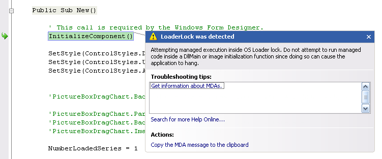

We try to migrate our .Net solution (Teechart v8) with the new Teechart v2010 component.
We have used Project upgrade utility to upgrade our project. Migration was done successfully but now, the project does'nt work (no compilation error, references ok (Teechart 2010)) but it crash in InitializeComponent method.
We can't send you source code because project is huge and uses WebService references.
Why does our project works fine with v8 and not with v2010 ? How can we solve it ?
Guilz

Hi Guilz,
There was a customer who had the same problem some time ago.
Googling a little bit we found that the Loaderlock exceptions can be deactivated as explained here: Go to Debug\Exceptions and deactive the "Thrown" checkbox at "Managed Debugging Assistants\LoaderLock"
At the same time, the customer told us that the problem was solved by changing the platform target in Build of Project properties from Any CPU to x86.
If you still have problems with it, please don't hesitate to let us know.

Thank you Yeray - Unchecking "Managed Debugging Assistants\LoaderLock" solve this issue. It is not necessary to change the platform target for me.
