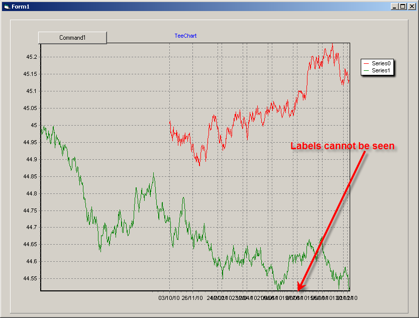

I would like to chart 2 series with .XValues.DateTime = False . 1st one charted on form load and 2nd one on button click.
2nd serie is larger then 1st serie. In this case I have the issue listed below.

Have you any idea how can I correct this.

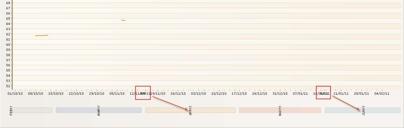

with Teechart v2011 we still have this bug
As you can see, we have 2 series (1 as fast line - Serie1, 1 as Gantt - Serie 2) the issue is that Gantt label are displayed on the bottom axis and we can't see the date labels of serie 1
We do not want to view Gantt labels on bottom axis but we want view them on Gantt chart (Months FEB11, MAR11, APR11, MAY11, JUN11 must be displayed on gantt chart but not on bottom axis where there is already date labels of serie 1
Thank you for your help

However, the code from Petar, in the beginning of this thread still reproduces the overlapping problem:
Private Sub Form_Load()
  Dim i As Integer
  Dim value As Double
  TChart1.Aspect.View3D = False
  TChart1.Axis.Bottom.Labels.DateTimeFormat = "dd/mm/yy"
  TChart1.AddSeries (scFastLine)
  TChart1.Series(0).asFastLine.TreatNulls = tnSkip
  TChart1.Series(0).XValues.DateTime = False
  value = 45
  For i = 300 To 720
    value = value + 0.03 * (Math.Rnd() - Math.Rnd())
    TChart1.Series(0).AddXY i, value, Format(Now - 365 + i, "dd/mm/yy"), clTeeColor
  Next i
  TChart1.Series(1).asFastLine.TreatNulls = tnSkip
  TChart1.Series(1).XValues.DateTime = False
  value = 45
  For i = 1 To 720
    TChart1.Series(1).AddXY i, value, Format(Now - 720 + i, "dd/mm/yy"), clTeeColor
  Next i
So this could be an slightly different problem than TV52015179.
I've opened a new VCL bug ticket with the code above translated to Delphi, that reproduces the problem for me here with the actual sources (TV52015820).
