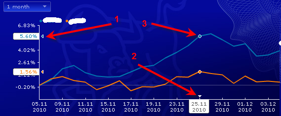

is it possible to display values for all series on mouse move as shown in the example below?
We would like to have on mouse move :
1. On left axe: highlighted values for each curve
2. On bottom axe highlighted value for the date
3. Dots on series to show where the mouse is

Thanks Narcis,
this is perfect for the dots part. Is it possible now to highlight values directly on the left and the bottom axis.

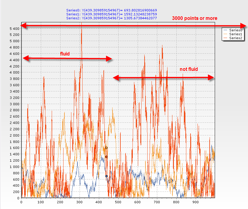

Hi Narcis,
This method works fine but there is some performances issue with a large number of points (>3000 points) :?
Is it possible to improve it especially when we move mouse cursor on the right part of the bottom axis ?
Thanks for your help :wink:
Guilz

Yes, highlighting could be done using Annotation tools, for example:

Regarding the performance issue, the problem is that interpolation is calculated from first visible point in the series and loops through all the points in the series. Hence it takes longer the further the point is from the origin. Some optimization could be done in the InterpolateLineSeries so that loop doesn't go through all point in the series.

Thank you Narcis,
that's exactly what we were looking for. Extremely useful.
Yes. I tried to use the code bellow to optimize the InterpolateLineSeries method (loop is now starting near the mouse position and not from the FirstValueIndex)
Private Sub TChart1_OnMouseMove(ByVal Shift As TeeChart.EShiftState, ByVal X As Long, ByVal Y As Long)
    firstIndex = TChart1.Axis.Bottom.CalcPosPoint(X)
It's seem to work fine
Thanks a lot for your help :D
