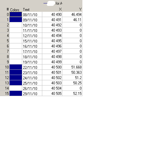

I have a problem while zooming on area with null Values. Hereafter you can see all my charted values

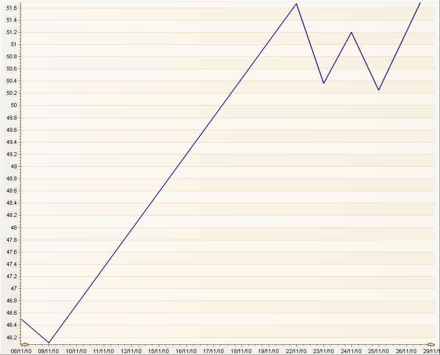

Before Zoom:

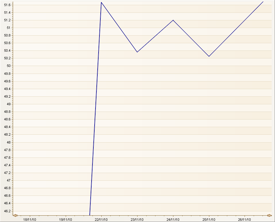

After zoom on 18/11/10 -> 28/11/10 area
At the beginning (before zoom) the slope of the curve between 09/11/10: 46.11 and 22/11/10: 51.668 seems normal.
Just after zoom the slope changes significantly (between 18/11/10 -> 22/11/10) , because it links the value 0 of 18/11/10 with value 51.668 at 22/11/10.
I would like to have the same slope as the one between 09/11/10 and 22/11/10, because all values between these two dates are Null values ( added with ADDNULLXY function), and so 18/11/10 value of 0 should not be taken into account.

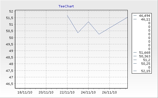

Hi Petar,
I see your bottom axis is zoomed but not your left axis. Do you only have horizontal zoom enabled? Code snippet below doesn't produce such a chart for me here. If I zoom around 18th November I don't get the first segment painted:
Is this what you expected? Which TeeChart version are you using? Could you please modify code snippet below so that we can reproduce the problem here?
