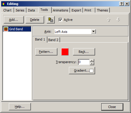

I'd like to set/change color band in Fast Line Serie. How can i do that ? Where is this property in the Teechart editor ?

I think you meant GridBand instead of ColorBand. This is how you could use GridBand at runtime:
Private Sub Form_Load()
  TChart1.Aspect.View3D = False
  TChart1.AddSeries scFastLine
  TChart1.Tools.Add tcGridBand
  TChart1.Tools.Items(0).asGridBand.Axis = TChart1.Axis.Left
  TChart1.Tools.Items(0).asGridBand.Band1.Color = vbRed
  TChart1.Tools.Items(0).asGridBand.Band2.Color = vbYellow
Through the editor, you should find it in "Tools\Grid Band\Band 1" there is a color shape, clicking on it, it shows the color picker.

Thanks Yeray, it is exactly what I was looking for :wink:
