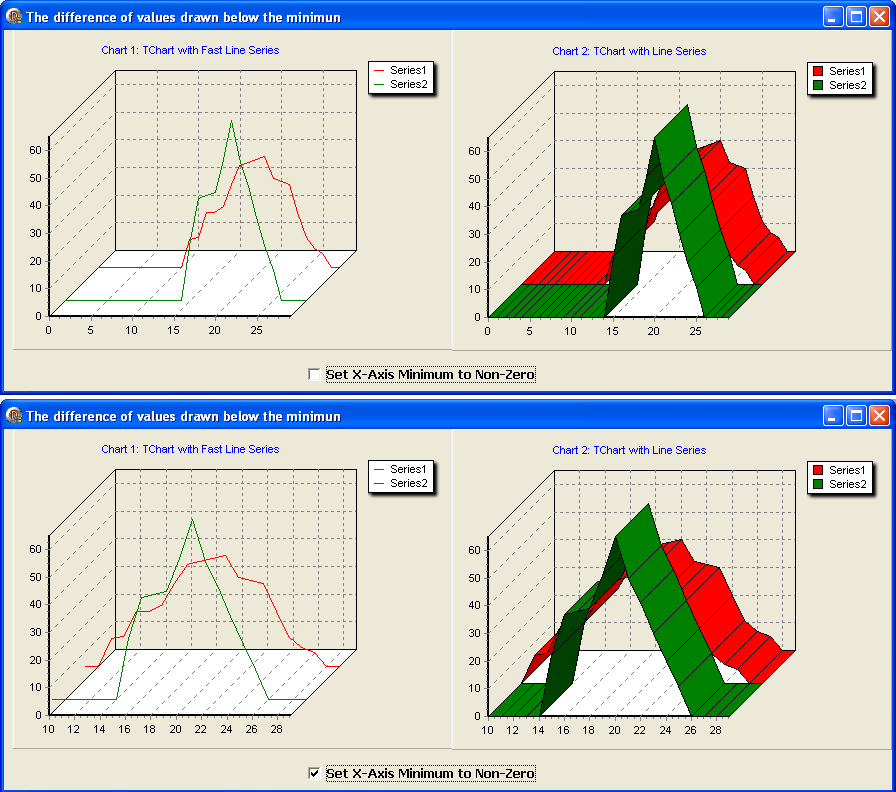

As you can see in the attached project, there is a problem with FastLineSeries in 3D if you set the Axis to not start at the minimum of the data. The problem does not exist with TLineSeries. In the image below - top section- you can see that if you start at the minimum of the data, in 3D, both the TLineSeries and TFastLineSeries start at the correct spot. However, if you don't start at the beginning (bottom section), the TFastLineSeries extends to the left of the origin. We are using TChart 8.04.
Is there any way to fix this problem? I have attached the full project as well.

Hi davidnovo,
I can not see any difference using your sample project with v8.07, which is the latest v8 maintenance release available at the client area. Can you please check if this solves the problem at your end?
