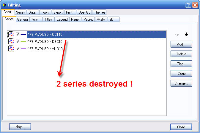

I would like to know if RemoveSeries method is the only method to delete specific serie on Chart ?
When i use RemoveSeries(1) method on my chart (5 series available), 2 series are destroyed (index 1 and 2) !
If I use Delete Bouton available on TeeChart Editor Control it is working fine (only 1 serie is destroyed)
I expect I do something wrong but I don't see where is my mistake...

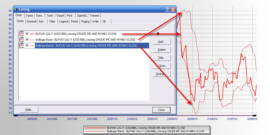

In my previous post about Bollinger you suggest to set property ShowInEditor to True to display it in Editor.
Look at this new issue: when trying to delete the first serie of bollinger series, Teechart component crash
At this step we delete Bollinger Band2. Working fine

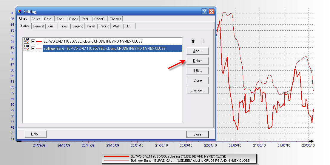

Now, we will try to delete Bollinger Band1:

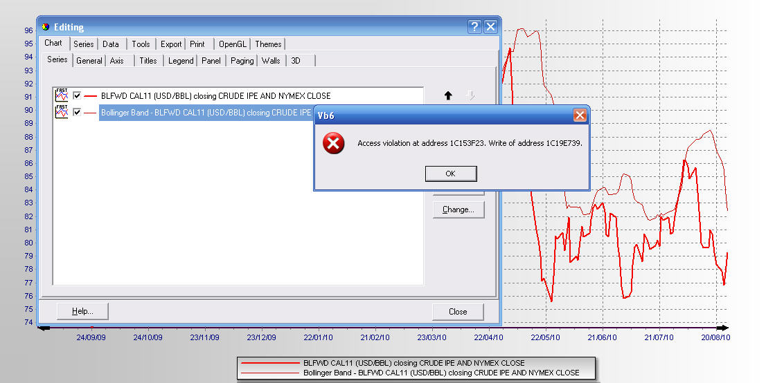

It is crashing with VB6 environment and with .Net.
Could you fix this issue ? Crash is never welcomed :lol:

Is the purpose of making visible the internal series to destroy it? If you don't want it to be shown you can simply set it Active = false.
However, you are right that having a source series and a bollinger function the IDE crashes if you try to remove the two last series, so I've added it to the defect list to be fixed in future releases (TA05015119):
  TChart1.Aspect.View3D = False
  TChart1.AddSeries scFastLine
  TChart1.Series(0).Pen.Width = 2
  TChart1.Series(0).FillSampleValues 100
  TChart1.Series(1).SetFunction tfBollinger
  TChart1.Series(1).DataSource = TChart1.Series(0)
  TChart1.RemoveSeries TChart1.SeriesCount - 1
