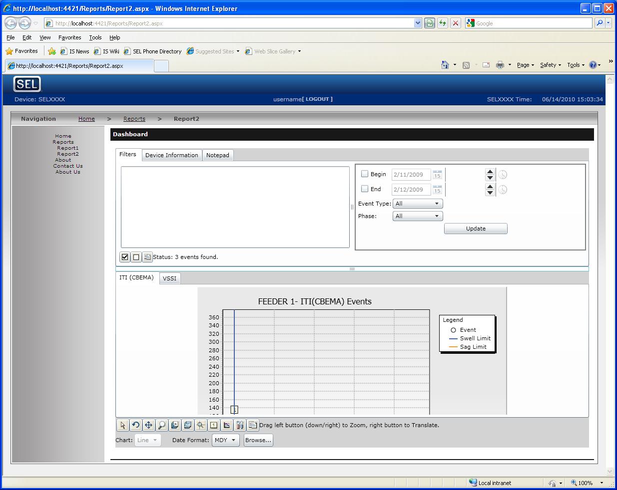

I have a simple Silverlight example that I cannot get to work. I noticed that this issue has come up before in the Forum, but I could not find out whether there is a solution, or it is a bug.
I have a tab control with two tab items. In each tab item I have a TChart control that is supposed to stretch to fill the tab item. If I assign a fixed size to the TChart control in the first tab, then the TChart in the second tab will automatically stretch. If I try to make them both stretchable, then the designer preview fails. If I replace the TChart control in the first tab item with a simple button, the button correctly stretches and so does the TChart control in the second tab item. I have tried all kinds of variations but I cannot get both TChart controls to stretch automatically. See attached code. Remove the hard coded dimensions of the first TChart control to reproduce the problem.
Can you help?

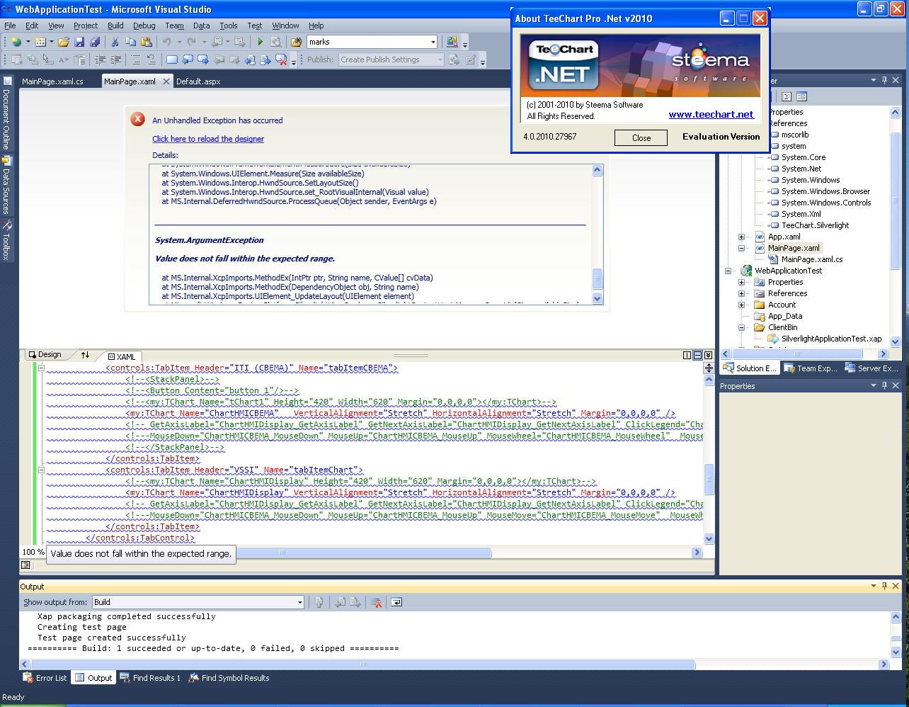

Post by BlueMonkey » Fri Jun 25, 2010 4:31 pm
Sandra,
I copied and pasted your code into a new project. I am not able to load the silverlight design page in the Visual Studio designer.
I am using Visual Studio 2010 (Version 10.0.30319.1 RTMRel).
I am using TeeChart.NET (Version 4.0.2010.27967 file version 4.0.2010.27966)
I get the following error if I do not provide a Height and Width property for the first TeeChart control:

at System.Windows.FrameworkElement.MeasureCore(Size availableSize)
at System.Windows.UIElement.Measure(Size availableSize)
at System.Windows.Controls.Grid.MeasureOverride(Size constraint)
at MS.Internal.Helper.MeasureElementWithSingleChild(UIElement element, Size constraint)
at System.Windows.Controls.ContentPresenter.MeasureOverride(Size constraint)
at System.Windows.Controls.Control.MeasureOverride(Size constraint)
at System.Windows.Interop.HwndSource.SetLayoutSize()
at System.Windows.Interop.HwndSource.set_RootVisualInternal(Visual value)
at MS.Internal.DeferredHwndSource.ProcessQueue(Object sender, EventArgs e)
System.ArgumentException
Value does not fall within the expected range.
at MS.Internal.XcpImports.MethodEx(IntPtr ptr, String name, CValue[] cvData)
at MS.Internal.XcpImports.MethodEx(DependencyObject obj, String name)
at MS.Internal.XcpImports.UIElement_UpdateLayout(UIElement element)
at Microsoft.Windows.Design.Platform.SilverlightViewProducer.SilverlightContentHost.MeasureOverride(Size availableSize)
Snapshot of Visual Studio with error

If I change the application name, then it does not match the content of the code behind file and I get a build error:
Error 1 The name 'InitializeComponent' does not exist in the current context
This problem seems to be specifically related to the Visual Studio design view. If I specify constant Width and Height properties, the design view appears and the application will run and display the fixed chart dimensions. If I remove the fixed chart dimensions (leaving the stretchable properties) then the design view gives the error "Value does not fall within the expected range.". However if I run the application in spite of the error in the design view, then the chart window will appear stretchable.
The conclusion is that if I want to see the design view of my GUI, I must supply fixed TChart dimensions. If I want to have a stretchable TChart in my runtime application, I must remove the fixed chart dimensions. I cannot have both.
It would be nice if the TChart would display correctly in the VS design view for both cases. Is this something you can fix?
Kent
