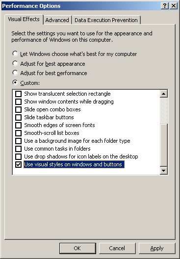

We've seen that on Windows 7, if you activate "Use visual styles on windows and buttons", the problem isn't reproducible:
But this option doesn't seem to have the same effect regarding this issue neither on Windows Vista or XP.

1) Setting the WINDOWS visual effects option has no effect on our XP development computer
