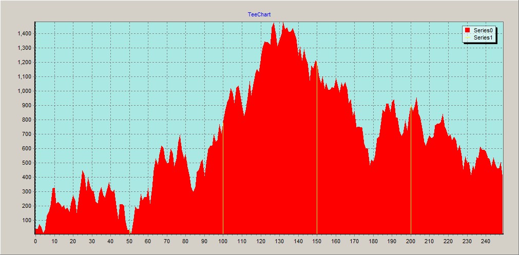

The following code tries to do a chart as similar as possible to yours:
Private Sub Form_Load()
  TeeCommander1.Chart = TChart1
  TChart1.Aspect.View3D = False
  TChart1.AddSeries scArea
  TChart1.Series(0).FillSampleValues 250

Both the generated test.jpg and saving it through the commander gives the same result for me here:
Could you please modify the code above or send us a simple example project we can run as-is to reproduce the problem here?

Yeray,
I was not able to duplicate the problem with your project. In the end I was able to fix it on my side by using the custom positioning setup for the Legend, programmatically similar to what you had done, rather than using the Designer to set it up with Percent Margins. The strange thing is that it worked with v.6 and 7 of TChart, but not v.8. It was only a problem with saving to JPEG, not with BMP.
