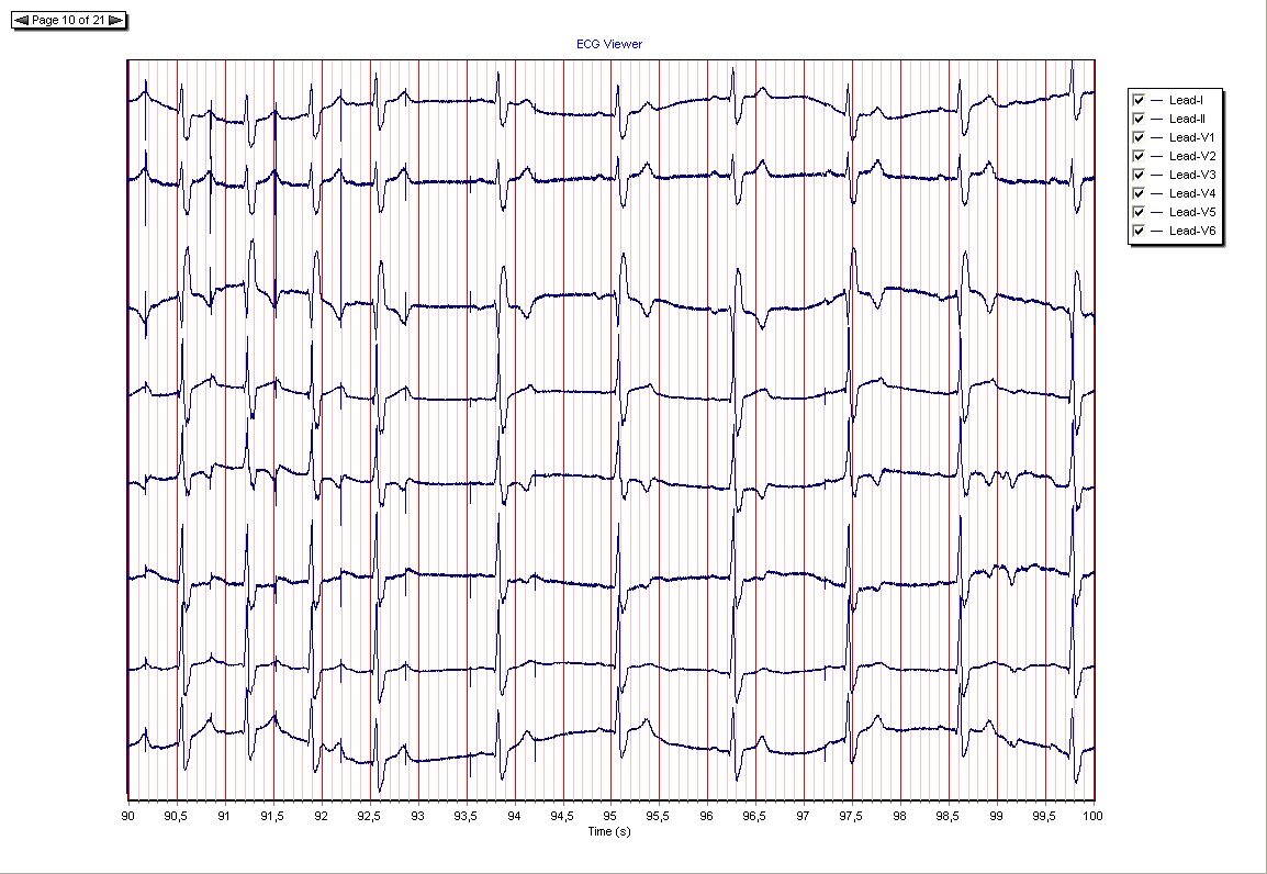

1-As you can see in the attached image I have 8 lineseries sharing the same X axis data.
My data is saved internally as integer (16 bits) without the x axis values. I need to know only the sampling frequency of the data. If I have 24 hours ECG recording with 1000 values/s. This gives 1000*3600*24*(2 bytes) = 172.8 MB for one ECG channel and about 1.4 GB for 8 channel.
If i want to add theses data to a chart then for each value we have (X,Y) on 2 doubles (2x8 bytes = 16 Bytes). This gives 1.38 GB by channel and about 11 GB for 8 channels.
My idea is to to make the 8 lineseries sharing the same Xvalues in order to reduce the memory usage of the chart. Is this possible ?
2- regarding printing with a user defined scale. Is there any example in the demo showing this possibility? I know how to compute the printer pixelperinches informations. But how can I pass these informatiion to the chart ?
