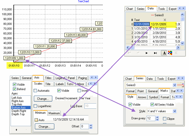

Hi Im using Techart Active X v7.0.1.4. It’s hard to understand how Teechart is handling date series!
In my sample there are 120 month end date points. I insert them into the chart with the Addxy() method.
1 ) Problem showing values on the bottom axis increment 1 Year:
Date values 1 year
As you can see on the bottom axis the correct dates are not shown. I wonder also where the minimum value is coming from?

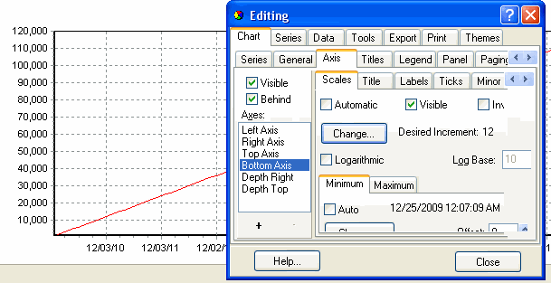

2) Problem showing values with 12 points
Date values 12 points
