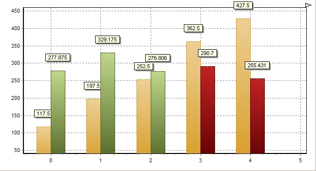

The values of the bar can vary. I attach an image of the bar graph.
What I want to do is to put gradient on the red series from darker red to lighter red and on the green series from darker green to lighter green. I already tweaked around with adding 2 separate series stacked on top of each other (Red and green), but when I showed the marks, the marks show for both of them.

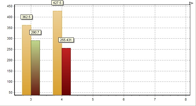

Oh ... I am sorry. I did not realize OnGetSeriesBarStyle is an event. There is another problem, though. If I scroll horizontally, if the color of the first value is green and the color of the second value is red, and the bar is right on the left edge, the gradient will change from red to green.]
Original
After scroll

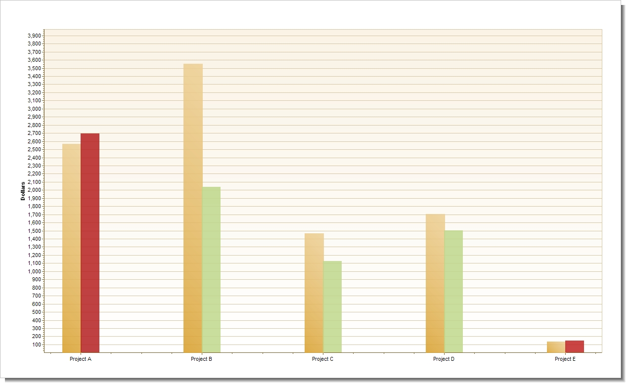

The bar fill color works. Is there a way to change the border color to match?

The problem is that the border colour is a property from the series so you won't be able to set a border colour for each bar. And this means that if we change the series' pen colour for the whole series at OnGetBarStyle event, as with my first suggestion for the gradient, we will have the same problem: we can use this event to change the series' pen colour when each bar is going to be drawn but this will be applied for the next bar, so we need to set a colour or another depending on the values at ValueIndex+1. And then, there is a problem when the first bar isn't drawn.
So another possibility would be simply deactivating the series' pen.
  TChart1.Series(0).asBar.BarPen.Visible = False
  TChart1.Series(1).asBar.BarPen.Visible = False
  TChart1.Series(1).asBar.OffsetPercent = 4
