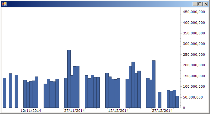

Also we found that RemoveGaps property is only available for some of the chart types like Candle. But it is not available for Bar chart or Volume chart. For example following code example gives us chart having gaps for weekend, which is an error.
DataTable CashVolume;
CashVolume = Graph.GetCashVolume() //DB Proc to Get OHLC Data
DateTime date;
double open = 0, close = 0, high = 0, low = 0, vol = 0;
Bar newBarSeries = new Bar();
newBarSeries.VertAxis = VerticalAxis.Right;
this.tChart1.Series.Add(newBarSeries);
for (int i = 0; i < CashVolume.Rows.Count; i++)
	date = (DateTime)CashVolume.Rows[i][(int)Graph.CashVolumeCol.TimeStamp];
	vol = (int)(CashVolume.Rows[i][(int)Graph.CashVolumeCol.Volume]);
	newBarSeries.Add(date, vol);
Bar Chart Having Space for Weekend
Bar Chart.png (12.66 KiB) Viewed 5940 times
It should be available for all available financial charts.

Quant wrote: Also we found that RemoveGaps property is only available for some of the chart types like Candle. But it is not available for Bar chart or Volume chart. For example following code example gives us chart having gaps for weekend, which is an error.
RemoveGaps was implemented for those series will mostly display DateTime values. Which series types you'd expect implementing RemoveGaps? Please bear in mind that not every TeeChart uses such series styles for financial purposes but for others: scientific, statistical, etc. Also, you can remove weekends as shown in the All Features\Welcome !\Chart styles\Financial\Candle (OHLC)\Axis Labels no Weekends example at the features demo included with TeeChart.
