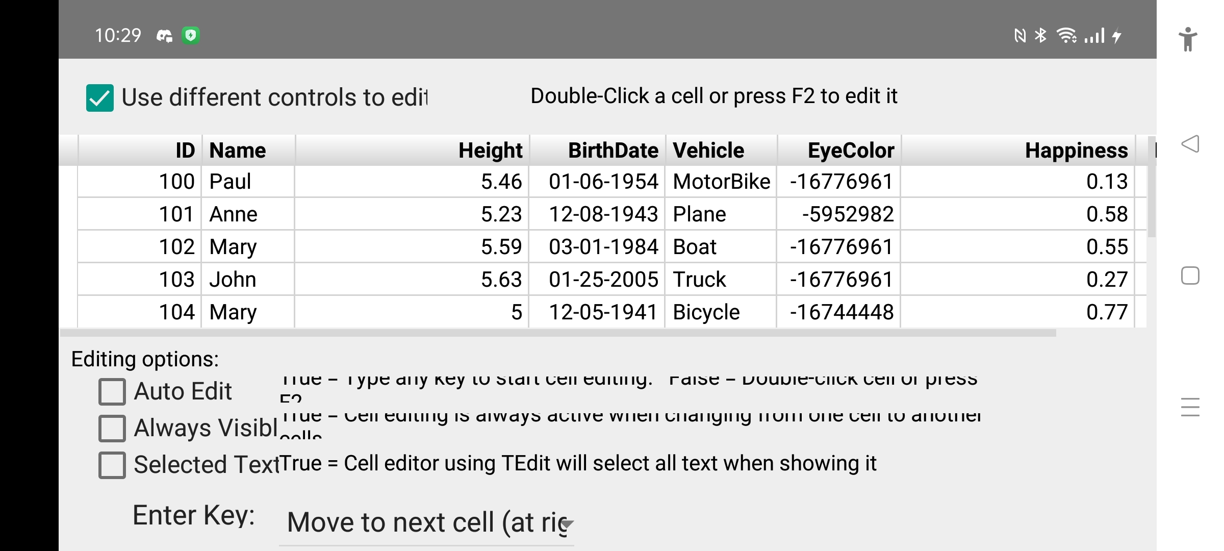

Just to confirm, a basic test of the Cell Editors example to Android 64 has run successfully to a mobile device.
Test consisted of:
- This demo: https://github.com/Steema/TeeGrid-VCL-F ... %20Editors
- RAD Studio build: Embarcadero® RAD Studio 12 Version 29.0.53982.0329
- Target: Android 64-Bit - Android SDK 25.2.5 64-Bit
- Configuration: to test-run, Development (not Application, as that will only compile the app as an installable package)
- Mobile device: Realme 6 mobile phone, Android 11
Output screenshot (we need to do a little work to improve the text panel layout :roll: ):
Check that your setup is similar to the list I've described above. If the difference still isn't obvious we can take a closer look at differences and possible causes of the problem.
