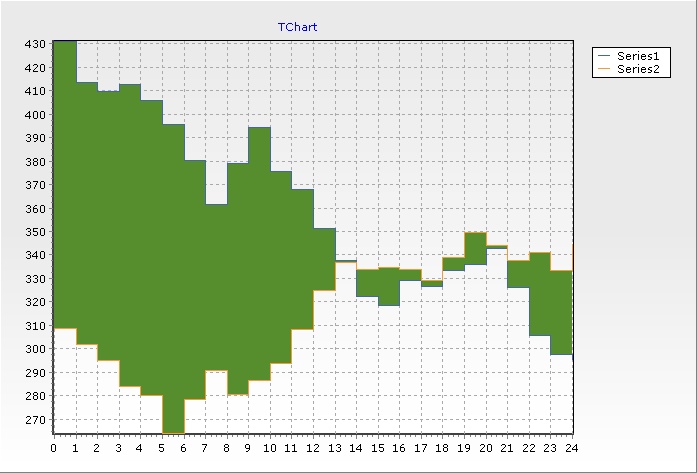

An image of how it looks like:

Re: Bug in SeriesBand
Post by JosefG » Wed Mar 17, 2010 7:50 am
again, this is an importand improvement for us. Thank you.
Also the above chart shows, that it would be very desirable if the color would change if the value of series2 is greater than the values of series1.
