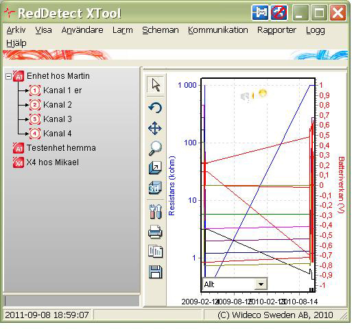

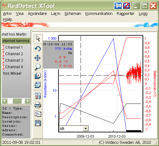

Helllo!
Well, its not a bug! But if you se the two attached pictures, in "full view.jpg" the tree at the left It is presented as I want it to be. In the "scrolled.jpg" picture you can se how it looks if it does not fit. In this case I would still want it to be left justified and the horizontal scrollbar removed/invisible (and in leftmost position).
Regards, Mikael
Regards, Mikael
- Full view.JPG (134.82 KiB) Viewed 95055 times
- Scrolled.jpg (165.3 KiB) Viewed 95020 times

Hello!
Sorry for the long delay, havent been working on this project for a while...
Already tried the Visible property but it does not have ant effect.
But I found another property MYTree.Selected.ScrollToView := False; which seems to solve the problem!
Regards, Mikael
