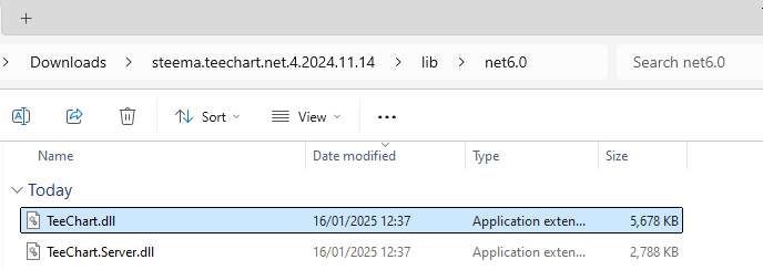

NuGet packages are essentially ZIP files, and you can extract their contents directly.
Steps to Extract the DLLs:
1.- Download the NuGet Package:
You can download the package from this link: https://www.nuget.org/packages/Steema.T ... 2024.11.14
2.- Extract the Files:
Rename the file extension to .zip (if needed) and use a tool like WinRAR or 7-Zip to extract its contents.
3.- Locate the DLLs:
Navigate to the lib folder in the extracted package. You will find subfolders containing DLLs for various versions.
Since TeeChart for .NET 6 is forward-compatible with .NET 8, these DLLs should work without issues in your WPF application.

Thanks to your answer, I was able to successfully extract the DLL from the TeeChart NuGet package and add it to my project! Thank you.
I used the net6.0-windows7.0 DLL, but I'm experiencing an issue where the Styles method does not appear in TeeChart.WPF.dll. Could you possibly know what might be causing this? Could it be due to other dependencies?
