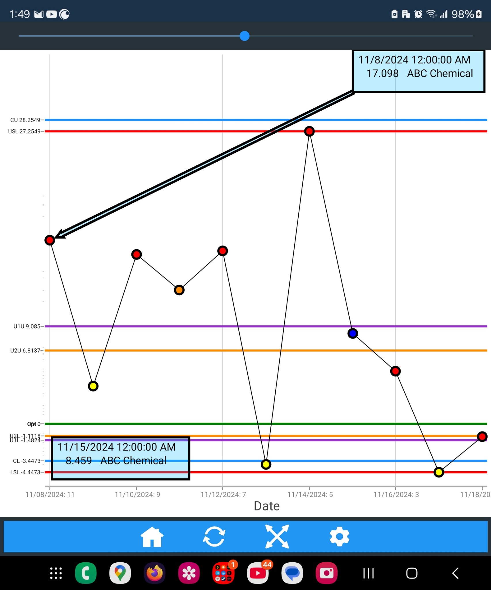

Here is a screenshot of so you can see it. The toast on the image is to help debug it.
In this case, the arrow should be from the bottom left corner of the popup to the 3rd point.
        #if DEBUG
            _ = Dialogs.Toast( $"{nameof(AnnotationTool)}.{nameof(Draw)}.{Active}.{currentPointIndex}.{line.Count}" );
        #endif

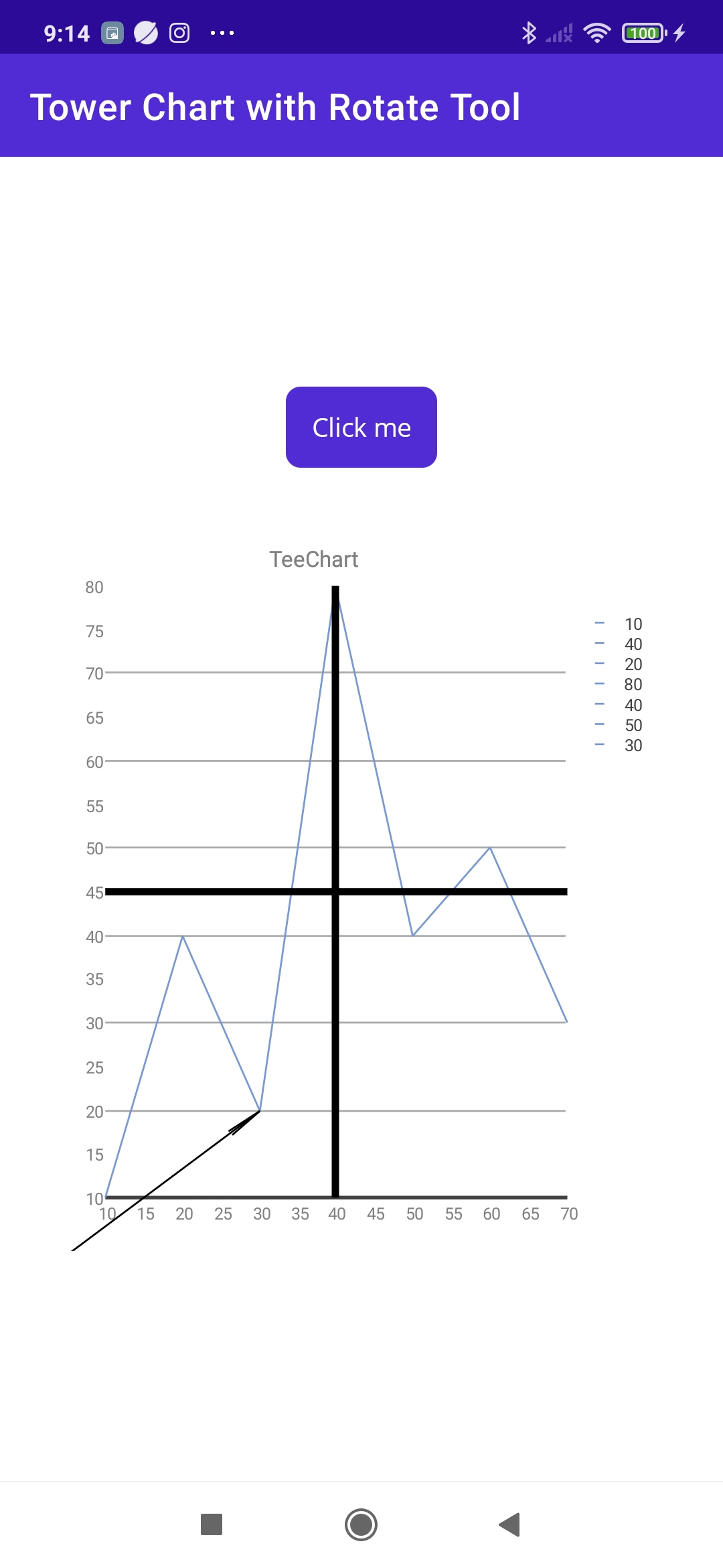

does the following code works for you ? it should draw an Arrow from left bottom corner to the third point in Chart.
        private void TChart1_AfterDraw(object sender, Steema.TeeChart.Drawing.IGraphics3D g)
            var series = tChart1.Chart.Series[0];
            int pointIndex = 2;  // Index 3
            double xValue = series.XValues[pointIndex];
            double yValue = series.YValues[pointIndex];
            int xScreen = series.CalcXPos(pointIndex);
            int yScreen = series.CalcYPos(pointIndex);
            int xStart = series.CalcXPosValue(0);
            int yStart = series.CalcYPosValue(0);
            g.Arrow(false, new System.Drawing.Point(xStart, yStart), new System.Drawing.Point(xScreen, yScreen), 3, 20, 0);

Post by Pep » Tue Nov 12, 2024 2:30 pm
sure, here it's the code used:
        public MainPage()
            var line = new FastLine(tChart1.Chart);
            line.LinePen.Style = Steema.TeeChart.Drawing.DashStyle.Dash;
            line.Add(10, 10);
            line.Add(20, 40);
            line.Add(30, 20);
            line.Add(40, 80);
            line.Add(50, 40);
            line.Add(60, 50);
            line.Add(70, 30);

Somehow, the annotation popup hangs around after it is redrawn/invalidated. Only the most recent previous popup is visible aside from the current one. In otherwords, once you click again, it will remove the 2nd oldest, keeping the previous and draws the new one.
The arrow from is the current one, the other is the old one.
