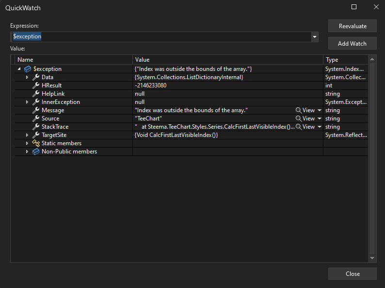

After a template is imported using the Load Command, it crashes after adding more the one point to the series. It crashes in 2nd LoadData. This example works if only 1 point is added.
Steema.TeeChart.TChart tChart1;
tChart1 = new Steema.TeeChart.TChart();
this.Controls.Add(tChart1);
tChart1.Axes.Bottom.Visible = true;
tChart1.Axes.Left.Visible = true;
tChart1.Axes.Right.Visible = false;
Line line = new Line();
tChart1.Chart.Series.Add(line);
LoadData();
TemplateExport template = tChart1.Export.Template;
template.IncludeData = false;
tChart1.Export.Template.Save("template.json");
tChart1.Import.Template.Load("template.json");
LoadData();
private void LoadData()
var line = tChart1.Chart.Series[0];
line.Add(1, 1);
line.Add(2, 2);
line.Add(3, 3);
Screenshot 2024-04-16 140524.png (29.3 KiB) Viewed 36911 times

Thank you for the issue report. We are investigating possible causes.

Hi, a fix has been made that will be included with the next update, due for imminent release this week.

Hi, the TeeChart nuget has been updated. The version includes a fix to the problem you have reported.
https://www.nuget.org/packages/Steema.T ... .2024.5.16

Thanks for that. Tried it out and is working now.
