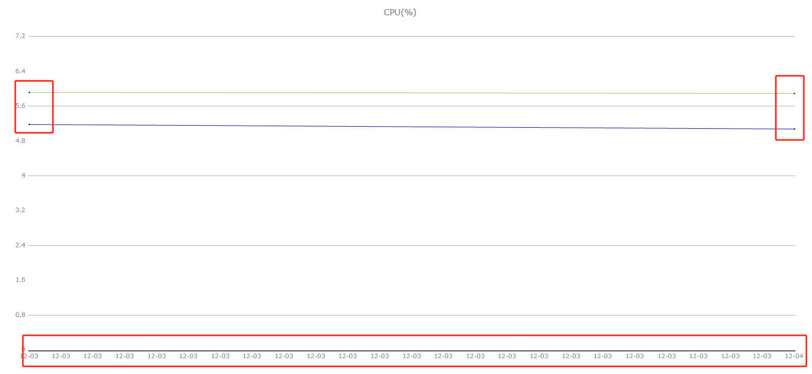

In teechart,My data only has two points, so there should only be two time labels on the x-axis. But he automatically generated extra x-axis labels that I don't need, how should I remove them?

Can this problem be solved?
Posts: 1299
Re: x-axis
Post by Marc » Tue Dec 05, 2023 7:35 am
You can set the Axis increment to the required spacing.
See: Axis Tutorial
Follow the contents link to Increment.
