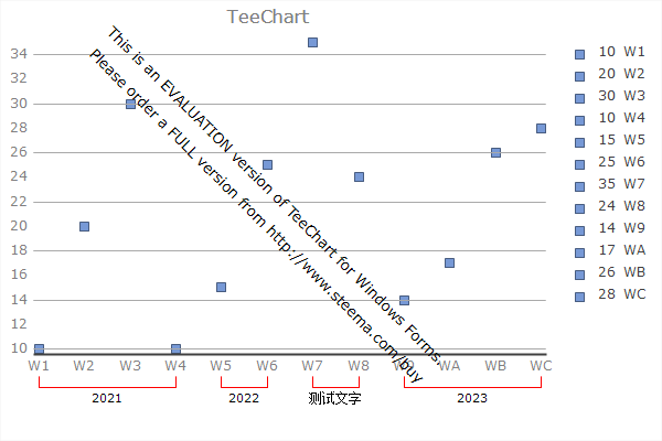

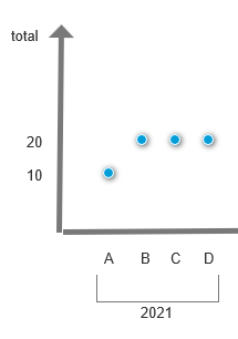

I want to custom the same year symbol, like the
or
Then I have try to use custom Drawing url,but failed.
how to draw the specified symbol above the year value
Could you help me please!
I hope the X look like
Through this result, I can directly see that A, B, C and D have the same year 2021.

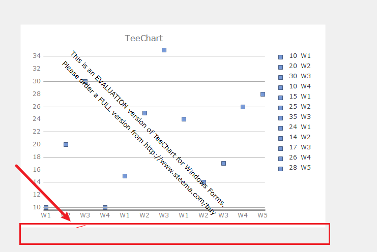

OK,I have draw the sample line.
But i have the next trouble is how to resize the chart canvas that can leave the space to draw my custom symbol.
I want to stretch vertical direction, and the chart Bottom can't change. like the red rectangle.
thus i have the spce to show my custom symbol.
And next question is, which function do i use to calc Y value?
I have use tChart1.Axes.Bottom.CalcYPosValue(0) eg.. but i can‘t see the point,I know it‘s exceed the canvas, so i want to know which one i should use to calculate the point Y value。
I think the fixed value like the 10 / 20 , to add the base value(tChart1.Axes.Bottom.Position) will cause the code ugly.
Posts: 1299
Re: how to show the merged X axes?
Post by Marc » Thu Nov 09, 2023 10:01 am
Re.
See my last answer about Margins.
Re.
A point is a combination of X and Y
ie. tChart1.Axes.Bottom.CalcXPosValue(0), tChart1.Axes.Bottom.CalcYPosValue(0)
Substitute that into the last example I sent you to test it.
