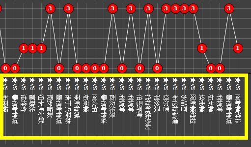

The above figure shows the position of the labels when Axis4. Labels. Angle=315
The following figure shows the position of the labels when Axis4. Labels. Angle=270
How to adjust the position of labels when Axis4. Labels. Angle=315 downwards and rightward

Thanks for feedback. Which version of "TeeChart" and "Visual Studio" are you using?

TeeChart: Steema TeeChart for .NET Source Code 2017 4.1.2017.02140
VS2019 [ VB.NET ]

Apologies for the delay replying. Currently, non-regular angles, (not 0,90,180,270), are not correctly rendering distance from the axis. We are reviewing the code related to this area.
Posts: 1299
Re: Position setting of coordinate axis labels
Post by Marc » Tue Nov 21, 2023 6:15 pm
The issue has been resolved (issues #2651]) and the solution will be included with the next TeeChart update.
I have ported this code back into the relevant method for the sourcecode version, 4.1.2017.02140, and although I am unable to test all possible usage scenarios for this version, it should work for you if you replace this entire method in the Axis.cs unit.:
