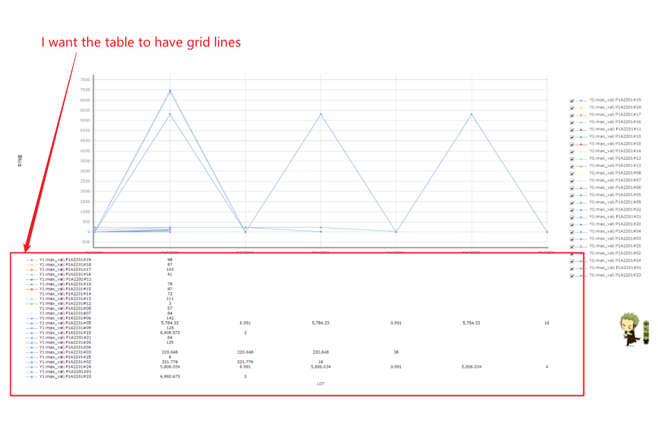

2) I want the table to have grid lines
need grid lines.png (124.09 KiB) Viewed 17522 times

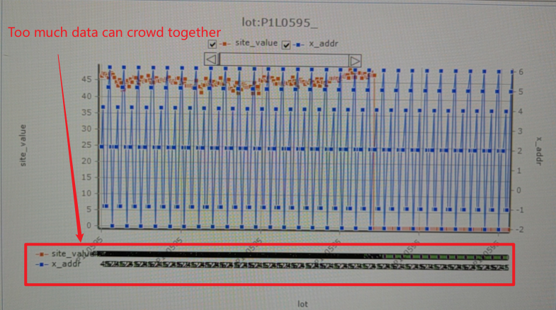

3) Data crowding together want to scroll bar
want to scroll bar.png (488.2 KiB) Viewed 17522 times
Open the Chart Editor after adding the tool go to the tool in the toolslist and select:
- Rows to edit the horizontal Pen
- Columns to edit the vertical Pen (display the grid lines)
The table can only practically fit a certain amount of readable data (text). If there are two many points the it is not possible to space the text. If you tell us what you would like to see here perhaps we can think of a suggestion.
