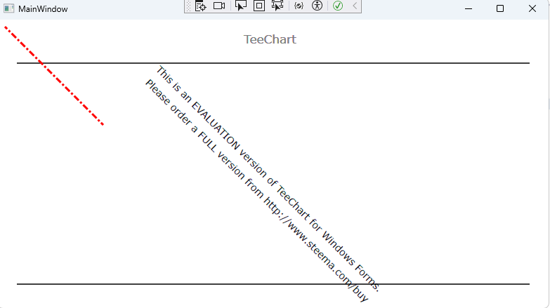

Hello Venkat,
here's a small example:
    public partial class MainWindow : Window
        private TChart _tChart1 = new TChart();
        public MainWindow()
            grid1.Children.Add(_tChart1);
            _tChart1.AfterDraw += _tChart1_AfterDraw;
        private void _tChart1_AfterDraw(object sender, Steema.TeeChart.Drawing.IGraphics3D g)
            g.Pen.Color = System.Drawing.Color.Red;
            g.Pen.Width = 3;
            g.Pen.Style = Steema.TeeChart.Drawing.DashStyle.DashDot;
            g.MoveTo(10, 10);
            g.LineTo(150, 150);
which here gives me:
Screenshot from 2023-07-28 12-10-07.png (33.95 KiB) Viewed 16410 times
Internally we convert System.Windows.Media.DashStyle to TeeChart.Drawing.DashStyle like this:
        TeeChart.Drawing.DashStyle IChartPen.Style
            get
                if (Style == DashStyles.Dash) return TeeChart.Drawing.DashStyle.Dash;
                else if (Style == DashStyles.Dot) return TeeChart.Drawing.DashStyle.Dot;
                else if (Style == DashStyles.DashDot) return TeeChart.Drawing.DashStyle.DashDot;
                else if (Style == DashStyles.DashDotDot) return TeeChart.Drawing.DashStyle.DashDotDot;
                else return TeeChart.Drawing.DashStyle.Solid;
            set
                Style = SetStyle(value);
And SetStyle:
        static System.Windows.Media.DashStyle SetStyle(Steema.TeeChart.Drawing.DashStyle style)
            switch (style)
                case TeeChart.Drawing.DashStyle.Dash:
                    return DashStyles.Dash;
                case TeeChart.Drawing.DashStyle.Dot:
                    return DashStyles.Dot;
                case TeeChart.Drawing.DashStyle.DashDot:
                    return DashStyles.DashDot;
                case TeeChart.Drawing.DashStyle.DashDotDot:
                    return DashStyles.DashDotDot;
                default:
                    return DashStyles.Solid;
