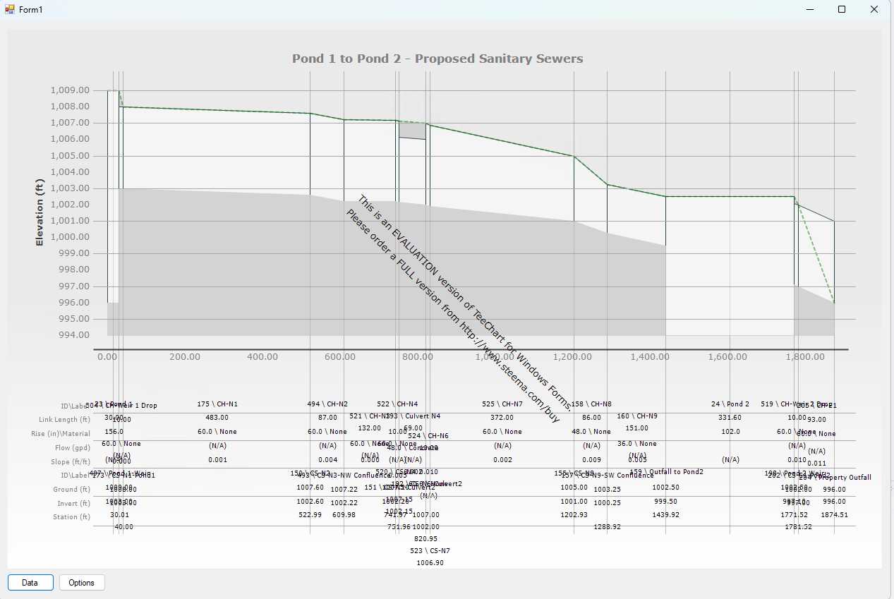

Thank you. Yes; I notice that the Custom Axes labels look quite different to start with:
Screenshot from 2023-05-15 13-34-15_2.png (475.24 KiB) Viewed 64846 times
And:
Screenshot from 2023-05-15 13-42-35.png (121.5 KiB) Viewed 64846 times
Can you explain why the labels are lined up horizontally in the top version, but are not in the bottom one? This might be an important difference.

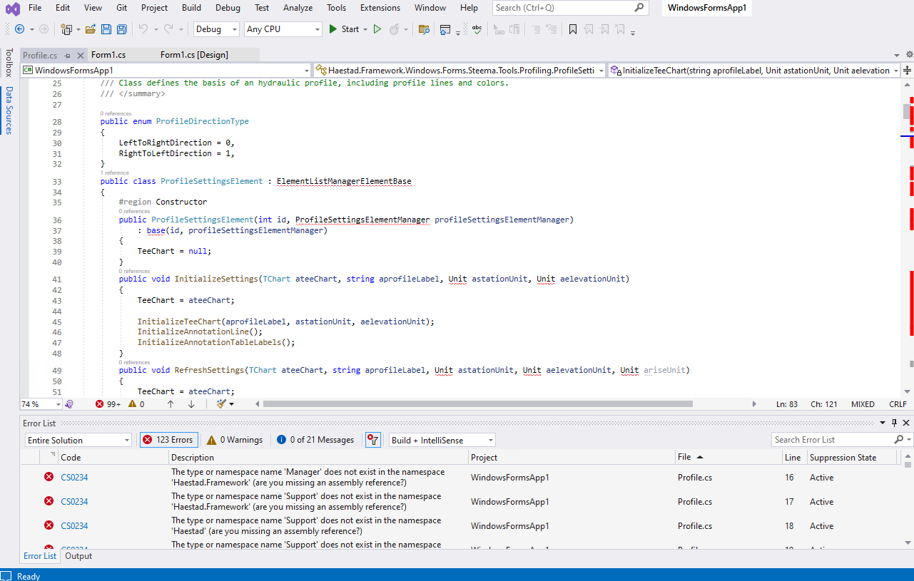

When I try to compile your Profile.cs, I obtain:
Screenshot from 2023-05-16 17-14-57.png (134.93 KiB) Viewed 64815 times
We usually ask for a minimal, reproducible example to speed up our responses to our clients. Is there going to be any way you can get one to us please? If not, maybe you could suggest the best way for us to try and get something up and running at our end.

I asked you for something more detailed in my last message in this thread.
As you can see in the screenshot in it, the example you sent us is not a minimal, reproducible example because it produces 123 compile-time errors when we try to run it.
The example you mention of loading a ten file is not minimal, as it gives us no immediate way to see the difference we encapsulated in our question to you:
Of course we are very interested in resolving this problem for you, but we really would appreciate your cooperation in being able to reproduce this issue at our end. As things stand we are going to need dozens of people hours to work out what might be going on, which unfortunately will mean our reply will not be 'ASAP'.
We will start investigations at our end today, and the first thing we'll try to understand is why the custom axis labels do not line up horizontally in the latest version.
