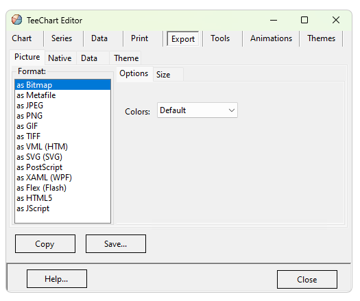

However, I think it would be more convenient for you if you could hook your code into all our NuGet releases too. If you could please give me an idea of what you need to do in the 'Save...' button code (the button being the 'Save...' button here)
Screenshot from 2023-04-12 10-40-47.png (18 KiB) Viewed 11696 times
Then I can hook up a delegate or whatever to pass in the variables to modify whatever it is you need to modify, e.g.
            void DoSomething(Tuple<double, int> myParams)
            var editor = new Editor(tChart1);
            editor.OnExportSaveDel = DoSomething;
            editor.ShowModal();
