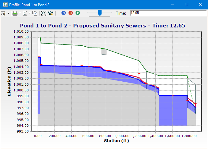

The first image is from our current release that uses v2009:
Graph before upgrading to v2022

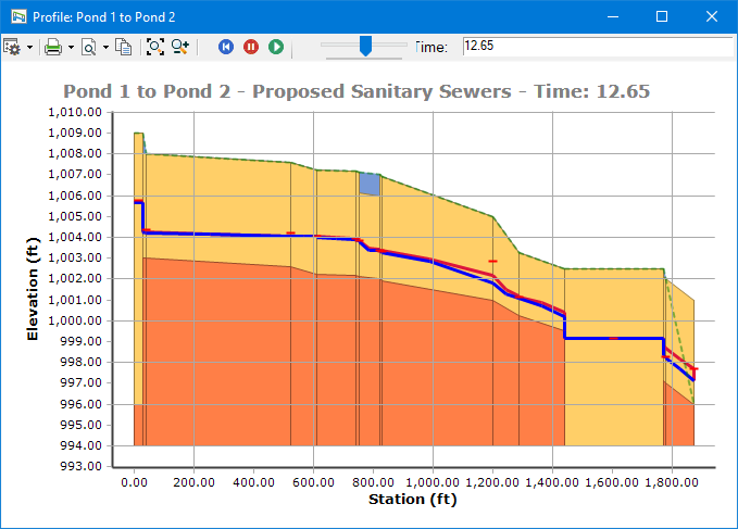

This is the same graph after upgrading to TeeChart v2022:
Graph after upgrading to v2022
If the colors were simply a variation on the shade of grey, that would be one thing. But to go from grey to orange is something completely different. I checked our code and we are using Color.LightGrey. How does that translate into orange by anyone’s imagination?

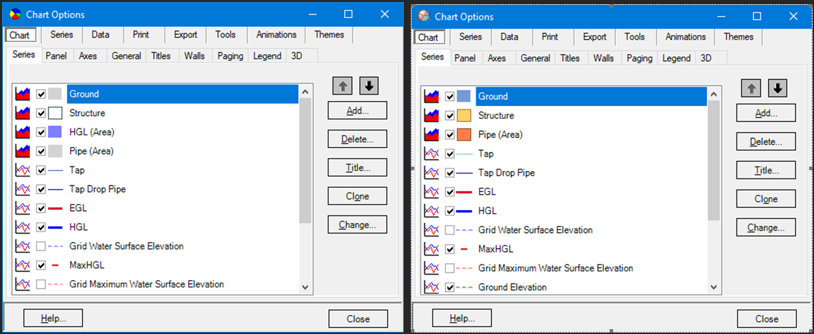

Here are the graph options. Left is pre-upgrade and right is post-upgrade:
Graph Options - Pre and Post Upgrade
In the options on the right there is a series missing (HGL (Area)) and the colors are wrong.

There is one last issue that needs to be fixed. If you look at the "Before upgrade" image in my original post, the area up and to the right above the [green] series is a grey color. For the life of me, I cannot figure out what this property is. I can't seem to find it in the chart options dialog, either.
I plan to give a demo showing the use of the upgraded TeeChart next week and if I leave that area white, I am going to be asked about it (that's how detailed my team is). So, is there a way to get that white to turn back to grey? If there is not, then that is what I will report but I need to ask the question.
