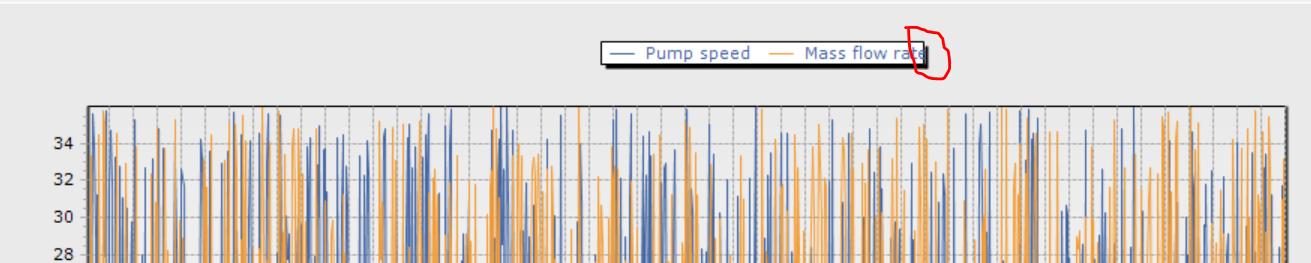

Hi. We are using Teechart .Net 2009 for a line chart. In a line chart, we are using data table for data binding.
Sample codes:
// Databinding
this.scalarChart.Series[seriesNumber].DataSource = dtChartData;
this.scalarChart.Series[seriesNumber].XValues.DataMember = dtChartData.Columns[1].ColumnName;
this.scalarChart.Series[seriesNumber].YValues.DataMember = dtChartData.Columns[3].ColumnName;
//Adding to legend
this.scalarChart.Series[seriesNumber].Title = TagName;
this.scalarChart.Series[seriesNumber].ShowInLegend = true;
The problem:
The last caption text in the legend is getting cut at the end. Please refer the attached pic.
Expectation:
Please suggest how to avoid the text getting cut? ( Note: I have tried appending a blank space at the end, but that also seems to have truncated automatically. have tried appending "\n". Did not work either)

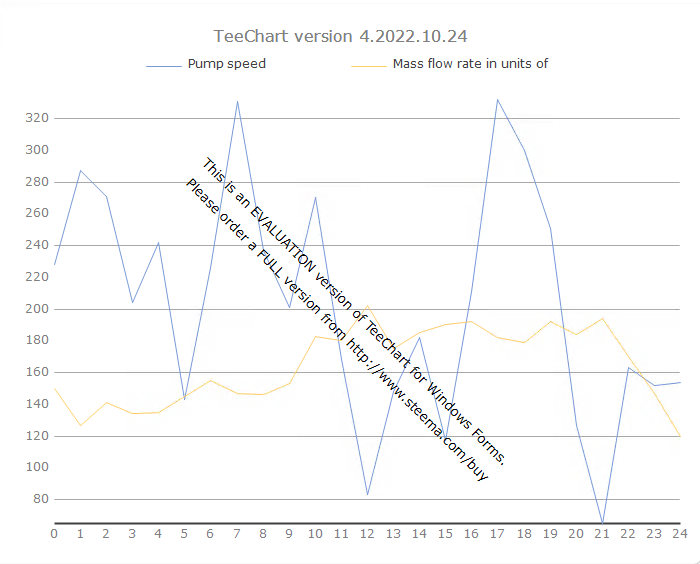

I've tried running something similar using the latest NuGet version of TeeChart for .NET Framework 4.0:
      var line1 = new Line(tChart1.Chart);
      var line2 = new Line(tChart1.Chart);
      line1.Title = "Pump speed";
      line2.Title = "Mass flow rate in units of";
      line1.FillSampleValues();
      line2.FillSampleValues();
      tChart1.Legend.Alignment = LegendAlignments.Top;
      var assembly = Assembly.GetAssembly(typeof(TChart));
      var fvi = System.Diagnostics.FileVersionInfo.GetVersionInfo(assembly.Location);
      tChart1.Header.Text += $" version {fvi.FileVersion}";
And the result I get is this:
Screenshot from 2022-10-31 12-38-23.png (80.08 KiB) Viewed 4710 times
Do you get a similar result using the latest NuGet?
