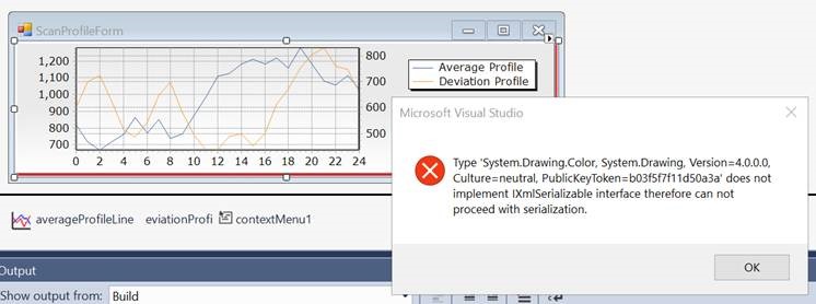

We are using TeeChart for .Net 2009 version for Windows Applications. Things were working fine so far, but recently getting error in Visual Studio when any changes made in tee chart control properties in a Windows Form in design time and saved. Attached is the error message for your reference. This is preventing us from adding teechart to any of our new Forms or modifying the existing forms
Requesting you to please take this this to appropriate technical team and investigate and let us know the resolution for this issue.

TeeChart version – Ref Attached pic
Visual studio Error Message
Teechart version info

This looks similar to the problem posted in this forum post—does 'Removing Steema.TeeChart.Styles.ColorList references from *.resx file' solve the issue for you?

Thanks Christopher. The reference thread given by you has helped me to solve the problem.
