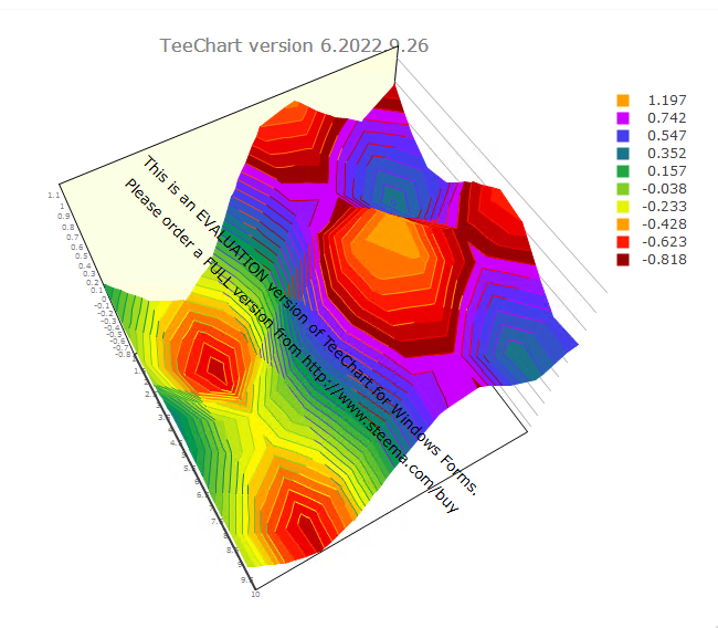

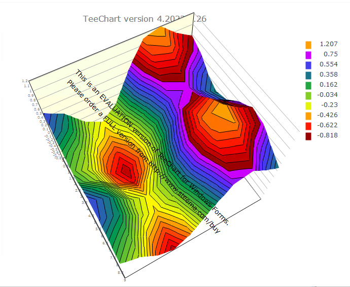

In .NET Framework 4.0 Windows Forms I get this:
Screenshot from 2022-10-04 12-31-31.png (279.76 KiB) Viewed 13205 times
and in .net6.0 Windows Forms I get this:
Screenshot from 2022-10-04 12-30-01.png (236.63 KiB) Viewed 13205 times

Our conversation went wrong.
4.0.2009.62332
In version 4.0.2009.62332,
a rainbow color is completed with one color for each wire.
4.2022.9.26 dotnet6 core
In version 4.2022.9.26,
a rainbow color is completed with multiple colors for each wire.
4.2022.10.11 dotnet6 core
In the latest updated version 4.2022.10.11, all wires are the same color. Black
Like version 4.0.2009.62332, I want the rainbow to be drawn with a color for each wire

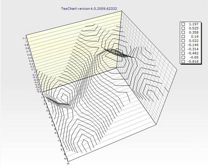

That code gives me:
Screenshot from 2022-10-19 11-02-44.png (243.57 KiB) Viewed 12989 times
The lines here are black—could you please modify this code so that I can reproduce what you want in version 4.0.2009.62332? Once I can reproduce it in this old version I can then have a look to see what the problem is in the present one.

please, Try running this code in version 4.0.2009.62332
You can see the difference.

Re: IsoSurface Issue with .net6
Post by Christopher » Thu Oct 20, 2022 9:51 am
sihmon wrote:
Thu Oct 20, 2022 5:29 am
Thank you, yes, now I can see the difference, and I have added this issue to our issue tracker with id=2562. We will look into it as soon as we can.
